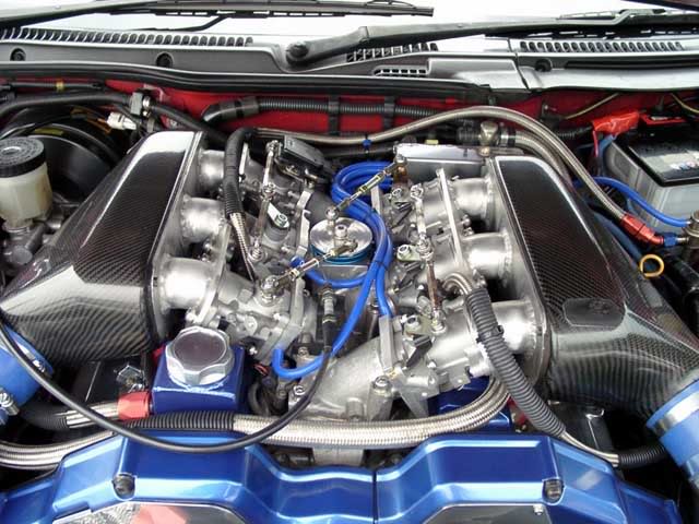

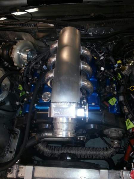

Heres one i made earlier.......

[ATTACH=CONFIG]69298[/ATTACH]
:thumbup1: more pics!! I really like that!!!!!!
thats actually what i had in mind without the throttle bodies but running 2 70mm billets at the end
