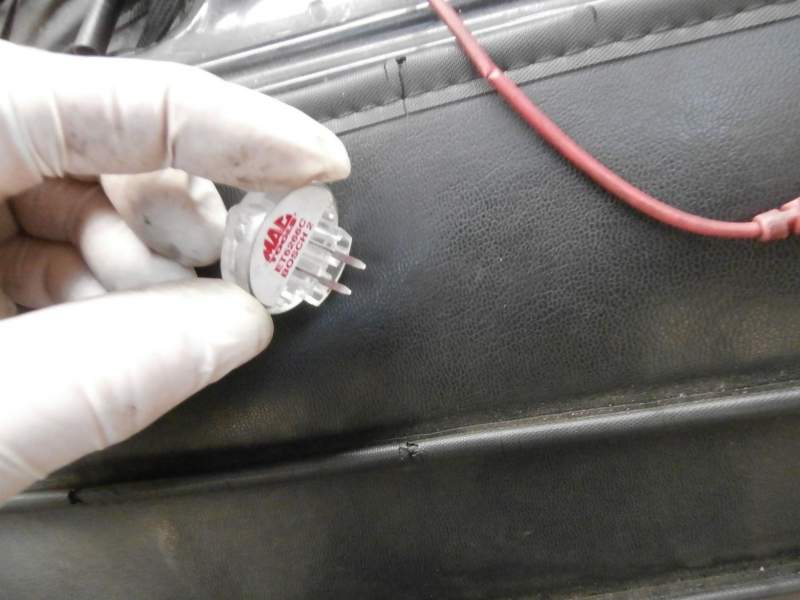

So pre-tests included identifying the cylinder not working, if the coil pack is firing, if there is an injector signal coming form the ecu and of course the ultimate resistance test on the injector itself.
A simple device but saves a whole lot of time when looking for faults, this Mac coil pack and spark plug tester flashes when close to a working coil pack, a second led flashes at a different rate and provides an idea of the plug spark condition... all without taking anything apart!!
So all six coil packs are firing and all six plugs have a good blink rate.

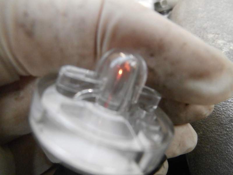

To test the injector output trigger signal from the ecu you need a "noid light" this is a small unit that plugs in to the injector electrical connector and then the engine is started, a steady blink that increases with revs is a good signal from the ecu, so that proves all good with the ecu and wiring loom.

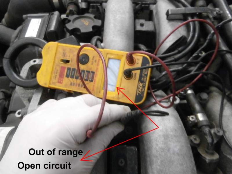

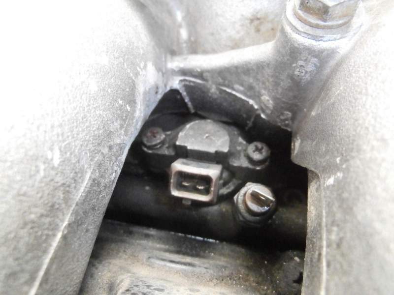

So again we see the test meter and a resistance check confirms an open circuit injector, so bring out the dremel again !!

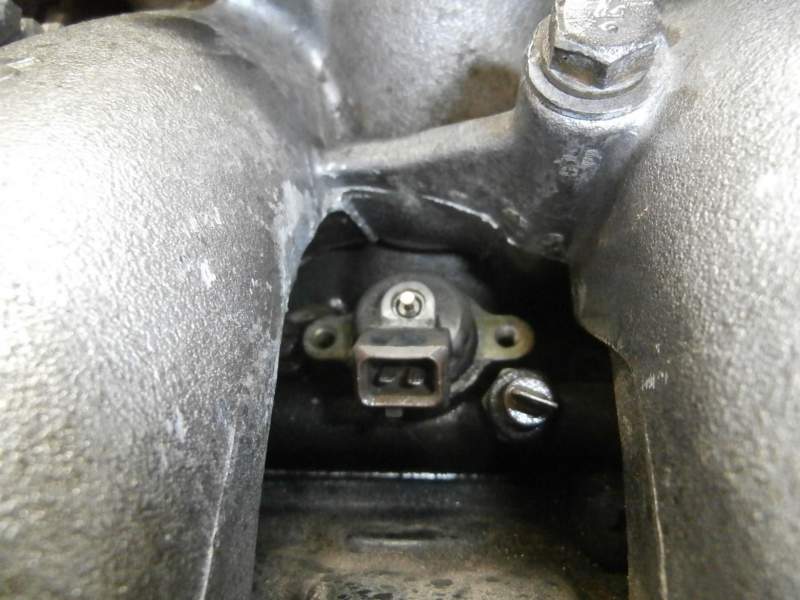

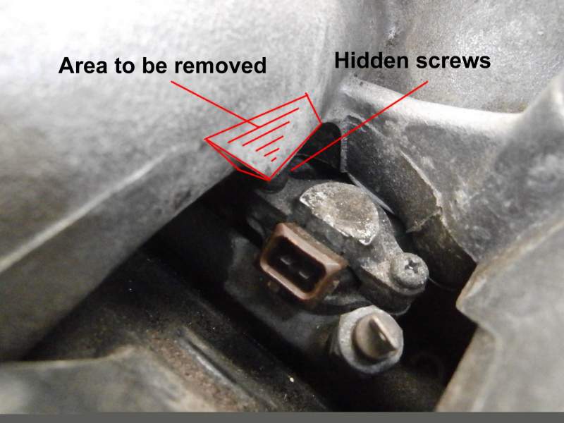

So the hidden screw issue is the same with no 2 cylinder, the space between the plenum is a bit tighter here so getting the dremel in is a little harder than the no 6 one I did the other day.

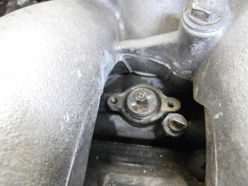

So fast forward, the dremel work is done and the plastic cap has been pulled off to reveal the steel section that can be grabbed with mole grips and pulled out..

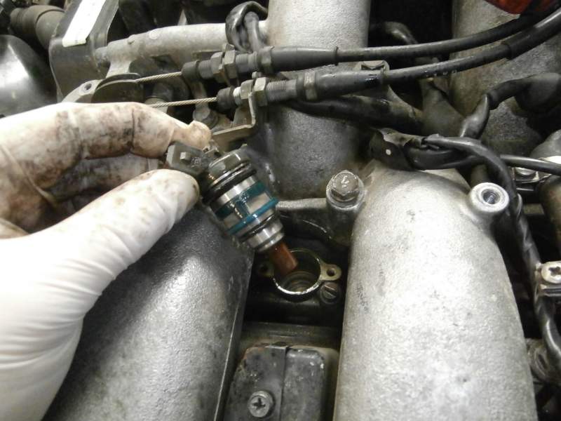

Replacement injector ready to go in
So the replacement is checked for a last time and fitted into the fuel rail

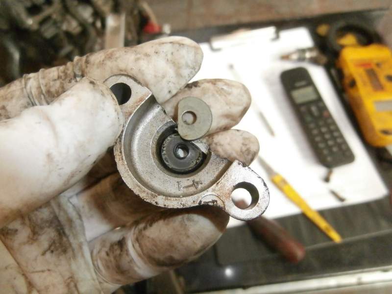

Worth mentioning, there is a small D shaped insulator under the bridge cap, this needs to be in but has a habit of dropping out as you go to refit it, a small smear of sealant will hold it in place just fine.
