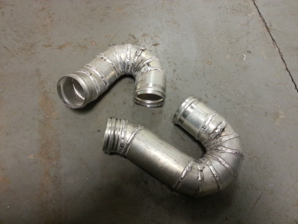

here ya go done from a smaller pipe to a bigger size replica
there are some real odd angles and twists you cant see a bit of a swine to do and i havent cleaned them yet by the way ;)
That looks seriously time consuming, do you use a purge line inside?
no like anything get the hang of not having to :) and some de buring
