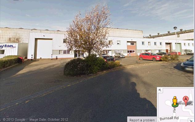

Would think thats unlikely, here are the guys who did the engineering work:
http://www.coventryboring.co.uk/#/at-the-heart/4537729699
