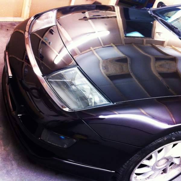

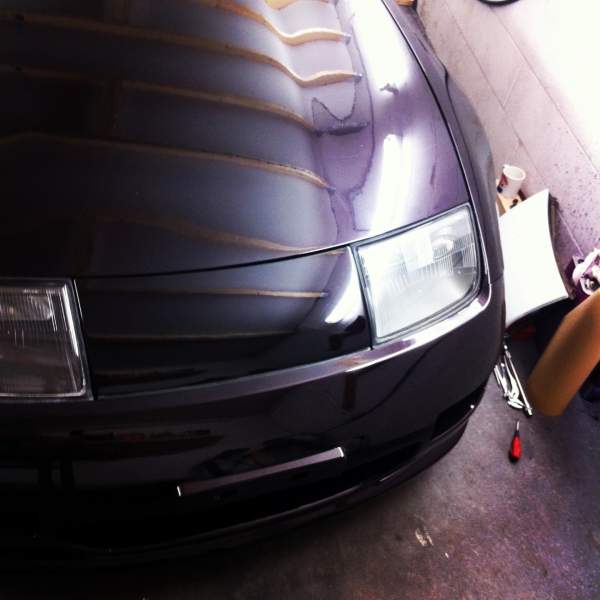

On a more positive note I've cleaned, clay barred and t cutted that bonnet, two more prep processes then il fit it, and the tyres turned up today and are waiting in my fish room for me :)
Mine has had new paint and is almost completely assembled and ready for polishing :)

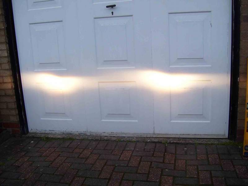

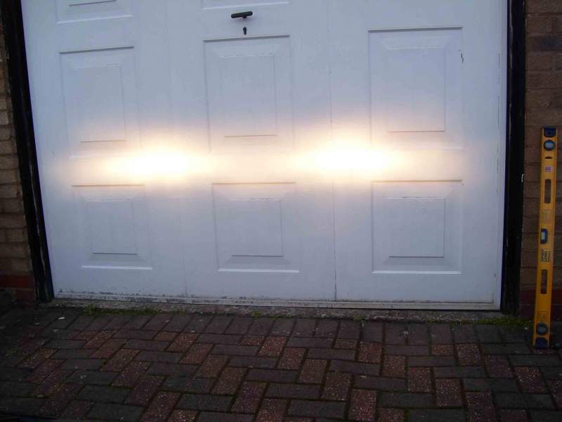

Well, after several attempts, I finally managed to get my headlights roughly set.
A bit embarrassing really. The first set up on the low beam a few days ago know were just, well, weird.
The pattern was nothing like I expected, so I changed the bulbs, this made things even worse.
One side looked good the other cr#p. Then it dawned on me, I had managed to fit the bulbs upside down initially.:blushing:
I confess to this so as to help save fellow members from falling into the same trap.:oops:
The pictures that follow are firstly main beam and then low beam.
Not perfect, but getting there.
I am still not convinced that I have not inserted the main beam bulbs upside down.
( is that possible? )

The bulbs should only fit properly one way, that is there is a half moon shape on the top and a notch on the bottom, therefore only allowing proper fitment in one axis,

Cheers Groover. :thumbup1:
