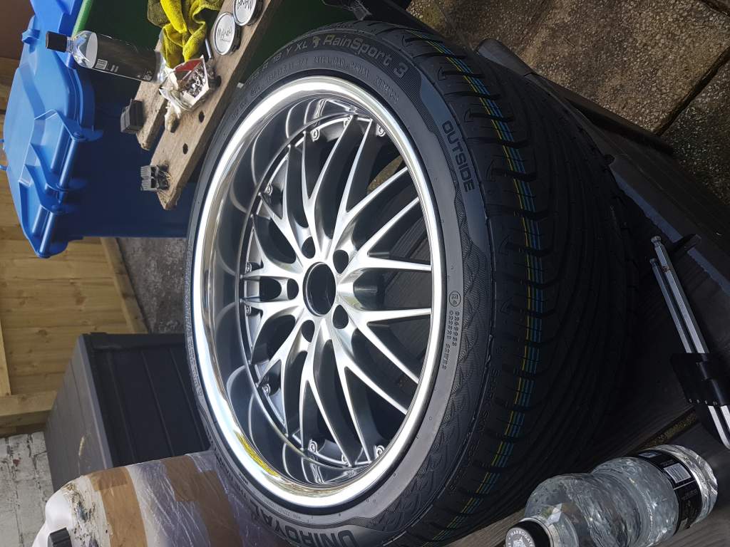

preparing my freshly refubished alloys for fitting. Went with 265/35/18 uniroyal rainsport 3's from Camskill
[ATTACH=CONFIG]100414[/ATTACH]
Are they for Zeb Ian?
