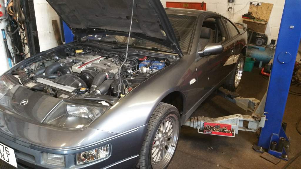

Took my new purchase down to Jim at PowerZed for the once over, to be fair the car is a testament to the previous owner, very good condition with only a few minor things that need some attention. PCV hose was replaced, MAF was diagnosed as being faulty (looking to buy a new one soon), and the rumble from the rear end is the prop or wheels need balancing (taking the car for the wheels to be checked first next weekend).
Up on the lift for a look over
All in all a good day, drive down was great, drive back on a Friday with stop start traffic....not so much..... but you can't have everything!

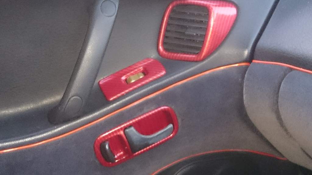

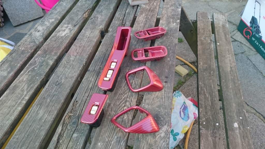

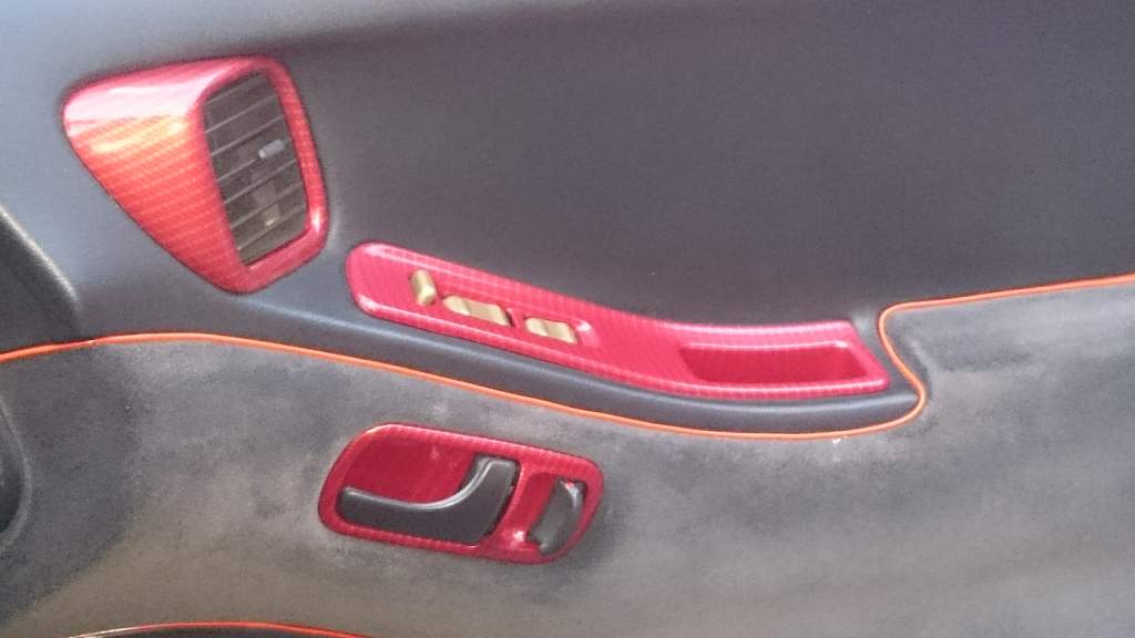

Got some more bits dipped today..
[ATTACH=CONFIG]97163[/ATTACH]
[ATTACH=CONFIG]97164[/ATTACH]
[ATTACH=CONFIG]97165[/ATTACH]
You're becoming quite the pro at this dipping lark:thumbup: Well done:thumbup1: I'm going to have to look into this, do you have a link for the materials?
There's quite a few places to get the supplies but the best I've found so far are these two..
http://www.Hydrographicswarehouse.co.uk
And
http://www.dipthis.co.uk
All you basically need is the film of your choice and the activator spray. They do clearcoat designed for the film but the normal automotive clearcoat lacquer is fine and to be honest it's probably the same stuff in a different can anyway!
Other than a good sized container and a thermometer that's about it.
I've found that keeping the water temperature at the right level is quite easy as the larger volume of water holds its temperature for plenty long enough to dip a few parts.
If you plan on dipping a lot or doing it in winter months then a decent fish tank heater will work.
I've had a good look at a pro set up and it's fairly basic, simply consisting of a large tank with basically a fish tank filter system which cleans the tank for you, a water heater and a temperature control.
As long as your water temp is around 28-30 degrees and you've taken the time to practice a bit and get to know the perfect dipping stage, then being a pro dipper really isn't that difficult..
Give it a go Richie, it's certainly a whole lot cheaper than getting it done.. Results may not be as perfect as a pro job, but that'll be down to you to get it right..
The parts I've dipped so far would have cost me in excess of £175 and it's cost me £40 with still enough materials left to do more. Can't really argue with that can you?

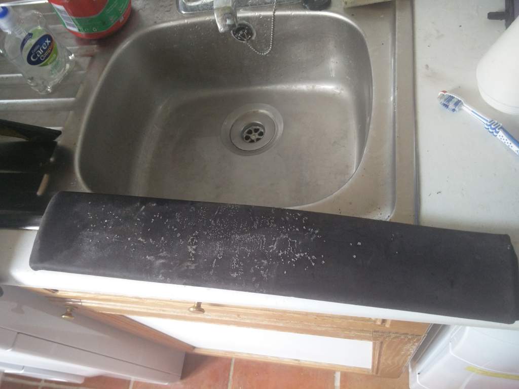

Interior cleaning this afternoon. Having been untouched for the past 6 years the interior was covered in a fair amount of cobwebs and mold !
Killed the mold with a white Vinegar solution spray, then cleaned up with a gentle soap using a toothbrush to get right into the short pile Alcantara cloth.
Left to dry in the sun.
