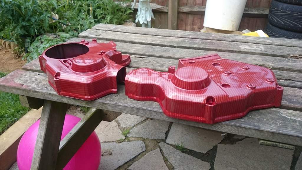

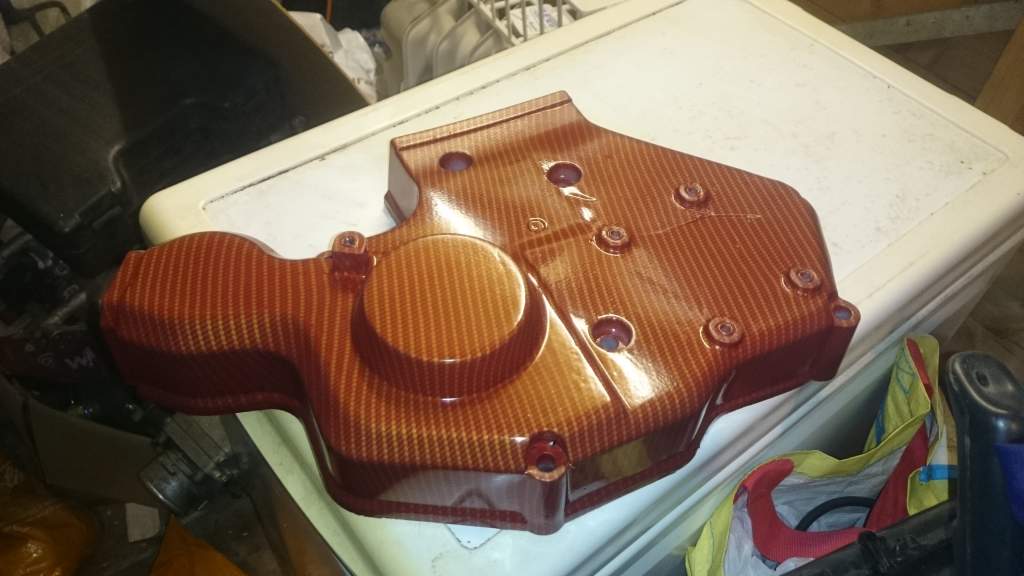

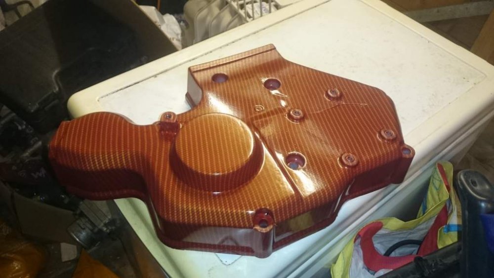

Well, successfully dipped the timing covers today.
Yup, they've had one coat, gotta go pick up a new can of lacquer tomorrow and build up those coats..
It should look sweet..
Got the fan shroud to do next.. Don't think I'll dip all of it as it's huge to fit in the tank.. Maybe do the top half that's visible..
Final lacquer coat now curing and I can honestly say.. Who needs to pay for hydro dippers?
Very happy with the final result!

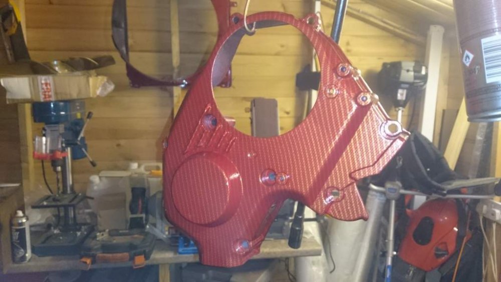

Got to move on to the trickier bit now... The radiator fan shroud... I've decided to dip the plastic trims from the doorcards aswell. They're colour coded already so why not huh? Lol.. Wish me luck.. DSC_0175.jpg
Your not finished Paul, you got to cut and polish to finish, you can just leave the lacquered finish as is, over time its likely to get grim ingress and also wet sanding with a fine grade, 1200-2000 then buff will make them shine like nothing and easier to clean over time:thumbup1:
You don't fancy changing your name to grim by any chance do you? Lol.. Have you seen the fine detailing on these covers? Don't know if I could get anything in between the bits and bobs sticking out of it!
I've got a dremel and some fine finishing paste so I'll give it a go.. Trust you to make me work harder! Lololol..
I must say though, they already very shiny.. :drool:
I wouldn't trust a dremel buffer, everytime i've tried wetsanding and buffing i just muck up the whole thing and have the pain of doing it again. They look good in the pictures, just don't spoil them :D
Dremel buffer is too small and can create tram lines. You need to apply a fair amount of pressure when buffing, so i use a 3" wheel with a polishing mop and finishing paste on something small or delicate.
At the end of the day if you are happy with the result then dont risk having to do it again if you feel you dont need too :biggrin:
I know what you mean, the dremel needs a real precision hand to get things right. I'm quite good with it though as I used to make jewelery and carvings with it..
Not really sure what to do now.. As the finish on it is really shiny, it makes me feel like leaving as is, but the finish isn't perfectly flat I do have to say.
I'll ponder over it a while as it in no rush to fit them. They'll be being fitted when I have the rest of my engine work done along with the freshly painted fan shroud, fan, plenum, turbo hoses and rocker covers.

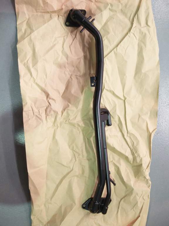

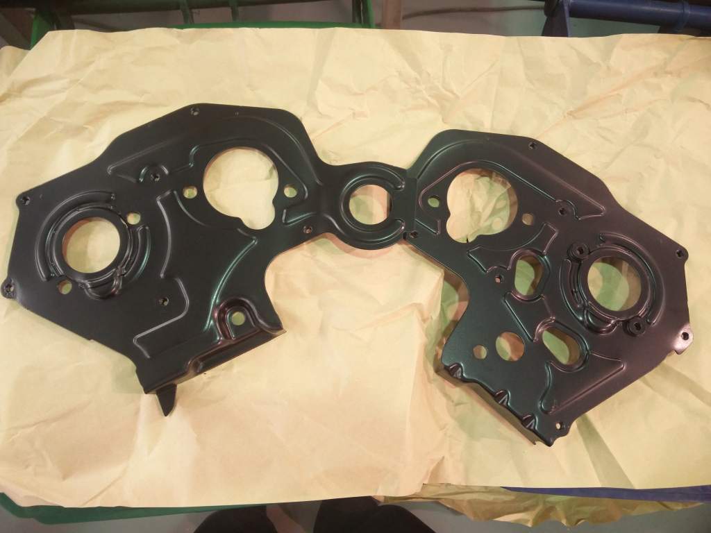

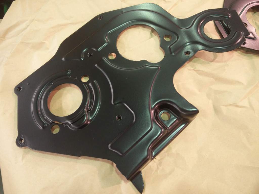

Picked up engine parts from Powdercoating. Shotblasted and done in Satin Black. Various parts - Headlights strips, camgear plates, balance bar, waterpipes, camcovers ..etc
A few pics of some of the parts :
Unfortuntly the 4 Cam covers showed quite a lot of pitting after shotblasing, so may have to source some replacements.

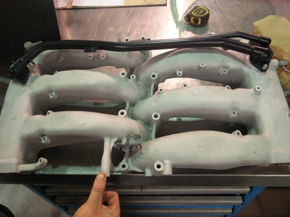

Also had the Plenum shotblasted only for now as not sure on the final finish and colour to proceed with yet

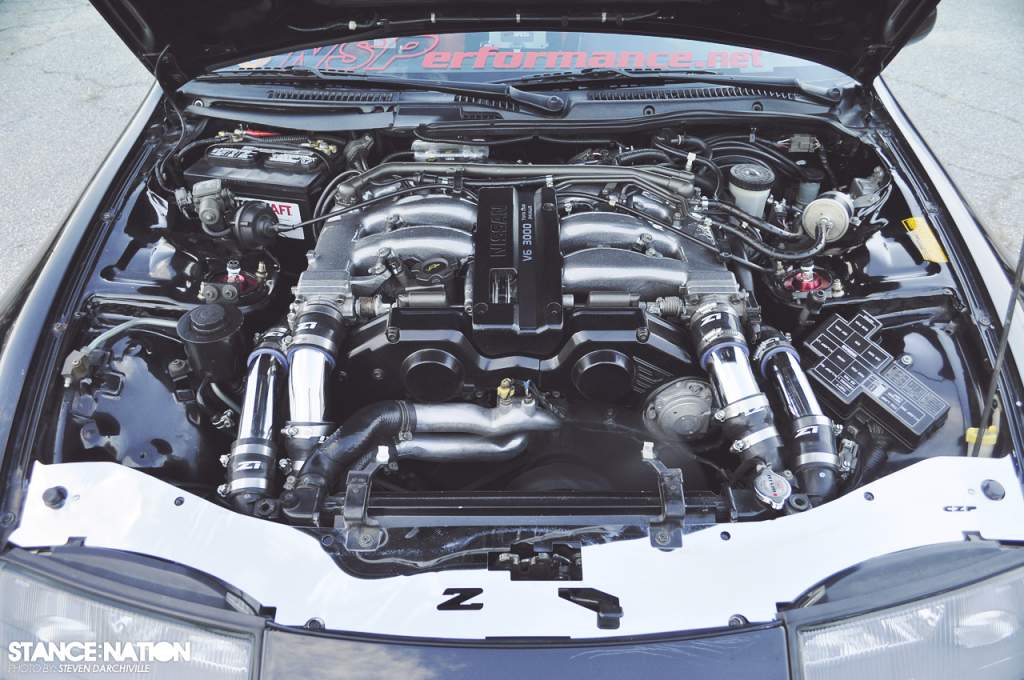

My plan I'm thinking of at the moment is to make one of those front bonnet cover pieces that go over the lock on the engine bay, and then over to the wings, and do it in a white carbon fibre, since having a big pool to dip it in. I might be a bit ambitious but I think it would look nice.
something like this i think
[ATTACH=CONFIG]97128[/ATTACH]
Yea, that's quite possible Alic, I'd recommend you really practice it and get the hang of it before you attempt a piece that size though.. You'll have to have a real steady hand to keep it straight and level as you dip, cos if the angle is wrong, the weave will distort..
As I said, if you have some time on a weekend, you're welcome to come and have a look at how it's done, and have a go if you like..
Cheers Paul, got a bit to do before the summer so cosmetic stuff such as that will have to wait, but nice to know.
[ATTACH=CONFIG]97120[/ATTACH][ATTACH=CONFIG]97121[/ATTACH][ATTACH=CONFIG]97123[/ATTACH]
[ATTACH=CONFIG]97124[/ATTACH]
Perks of the job eh! Looking today there Dave, I'd keep the plenum as it is matey, just clean it up again to bring out the silver but don't use any of that polish that goes black!
I've used this product with success:
http://www.frost.co.uk/frost-ali-clean-alloy-aluminium-castings-cleaner.html
Plenum came up very clean and bright.
