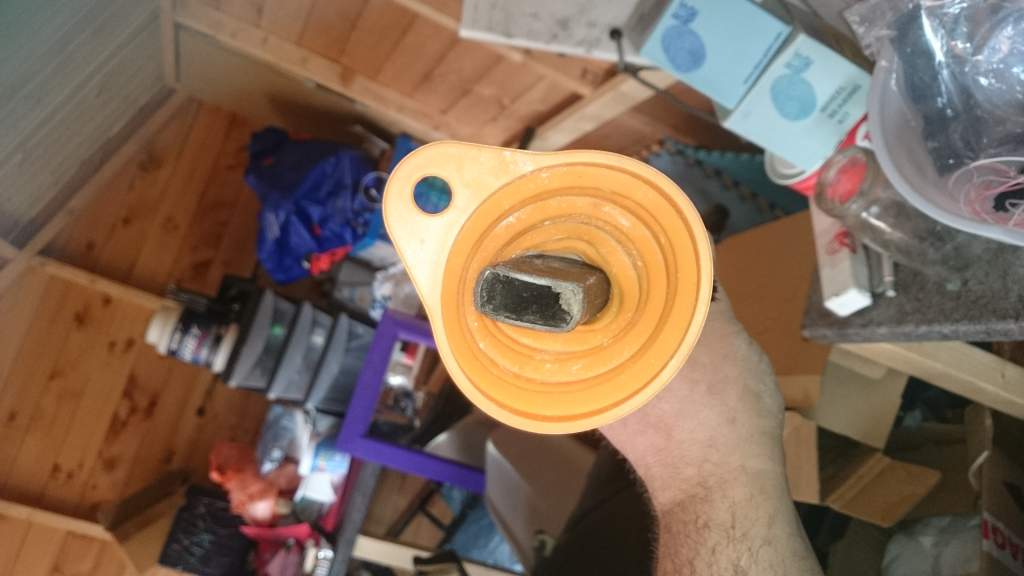

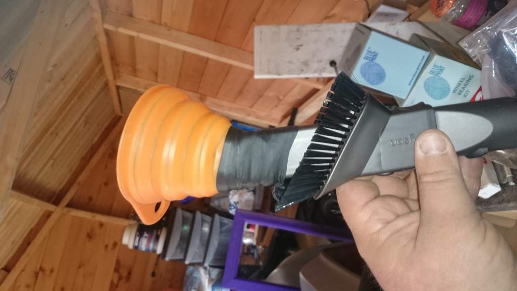

I'm thinking of trying to reseal mine with a hoover and some silicone. Put the silicone on the underside in the corner and then hoover it on the topside to suck the sealant in to the gap.
I've used this repair process before on an old Renault and it worked surprisingly well.

If it's worse case scenario, you'll be looking at a boot glass refit by a screen company. However the hoover and silicone job is pretty effective.
Just put a silicone funnel on the end of your hoovers hose end attachment and squeeze a little silicone in to the area indicated by the water mark left by the food colouring, then from the outside of the boot, place the silicone funnel over the area in the corner of the boot and switch the hoover on for a few seconds at a time until you see the silicone appearing through the seal. Wipe off the excess and allow to dry..
Simplezz!!
Silicone funnel available on ebay for £1.99

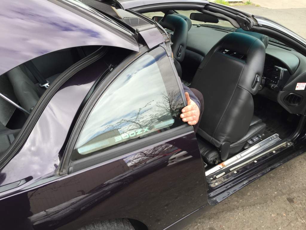

Went to LA Autos, Lee fitted the 99 spec rear lights,
And the Altia quarter shades :-)
So pleased with both Phutumsch and Lees work.

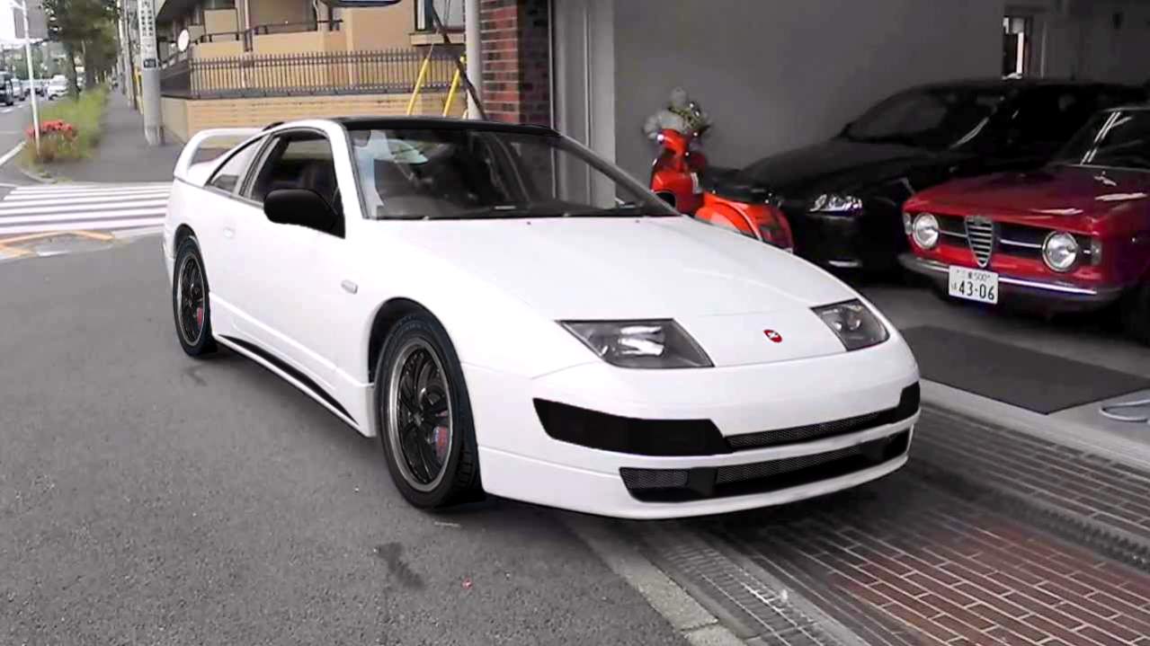

I can see your point of view about flat white, which is why I am going to break it up with black bits. Not to everyone's tastes but IMO looks very stylish.
Who knows, I may experiment with a black spoiler, but Si will probably shout at me :rofl:
[ATTACH=CONFIG]96819[/ATTACH]
Also think that's looks good, different too. I want mine to look unique but stay classy. Can't really think of anything..
