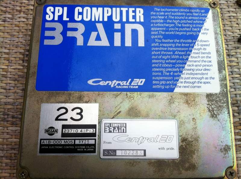

i've had this ecu in the garage for a while now and dont know anything about it. it was removed from a breaker that i stripped last year for its engine. i have searched all over the internet but cant seem to find much info on it

I've had a C20 ECU before.
On the C20 map I have before my very eyes right now:
11050rpm limit. Timing mapped up to 7500rpm, fueling up to the standard 6400rpm. Both fueling & timing only mapped to STOCK load (boost) levels. For fueling this is 88, timing 96 (these are arbitrary values). Just the same as the JWT maps, well over a decade old and created when hardware consisted of EPROM emulators and/or burners and software was archaic. Kind of obsolete now.
Timing is way too advanced for anything less than 105RON. Its 6°-7° more advanced than the stock JDM map at heavy load. This equates to 24°-27° at full load. That's race fuel territory...
Fuel map is terrible, same as stock until medium to heavy load, then just dumps in a load more fuel. This is a bodge way of having suitable fueling past the load point of 88 off the end of the map, so to speak.
AIV flags disabled. Fuel increase rate 94%. Safety RPM limit same as stock 4400rpm. Speed limit disabled, fuel cut disabled.
It's a typical old school JDM overly-advanced map. I personally wouldn't use one.

cheers noz it wont be going into my slicktop till i am 100% sure its not going to bodge my engine up sounds like u know your stuff i'l have to get my uprated ecu from the slicktop 2c what the crack with that is

Years of mapping Nissans for ya :D

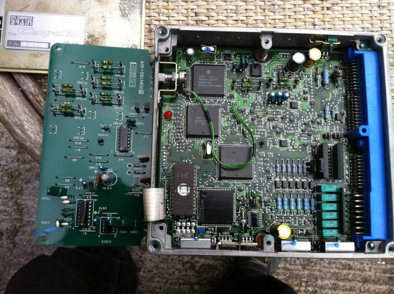

There is no guarantee that the map in this ECU is the same one as I first analysed years ago, you need to check each specific chip to be able to say 100% how it is programmed.

Quite simple really. If the chip in that ECU is the same as the chip I analysed from another SPL Central 20 ECU, it isn't suitable for cars over here.
I've laid out actual real data in the previous post, entirely up to you whether or not to heed it or listen to others. Best solution: Have that specific chip analysed yourself :)

In all fairness, you don't even know what map is in the ECU. Just because it has a sticker on the front, you don't know what the chip contains. Have it analysed and then you'll have all the info you'll need.

Ohh the same ECU as mine :) .
But i allready change my chip to a diffrent one :P
Nop, and i think chip was allready diffrent when i buy this car.
