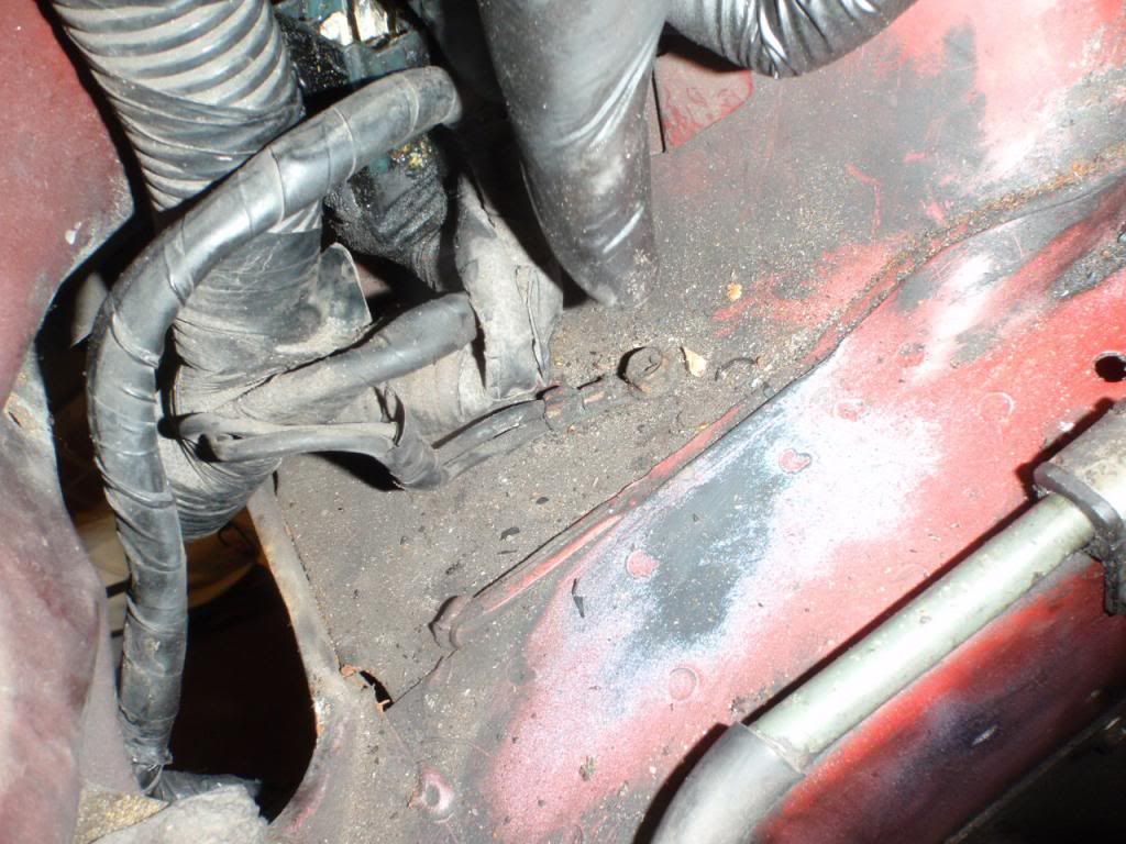

So does anyone know of the earthing points for any of the indicators loom please as im sure its gonna be a bad connection. Unfortunatley it decided to stop working 1hr before mot time(so sadly failed).
There are two earths for that loom I know of and they are both behind each headlight just on the outside of the chassis legs. A black cable with a metal loop on the end held down by a single M6 bolt. I can't find an actual pic but if you're not sure where I mean let me know and i'll add some 'paint' arrows to a picture
Edited by Eggs
Found a pic, this is the drivers side just behind the headlight, it's near enough the same place the opposite side
Cheers eggs. Will check this today. I take it that it wouldnt effect the drivers side side lights if this earth was oose as that still works fine.
