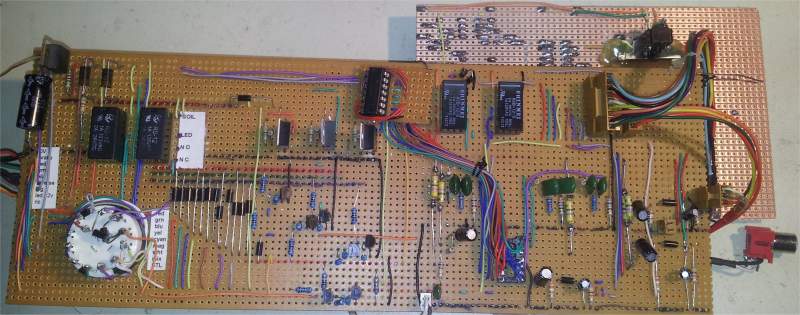

300zx rear light panel sound to light controller with brake repeater
This has various modes:
Manual colour select. Blue Red Magenta Green Cyan Yellow White plus one custom programmable colour
True sound to light (red = bass, green = mid, blue = treble) - this is my personal favourite
Pulse mode - pulses from darkest colour (blue) through to lightest colour (white) on bass beats in this order : blue red magenta green cyan yellow white
Step mode - steps colours in sequence on each bass beat, or you can auto step without music and set speed from mega fast to about one step every two seconds. Steps in same sequence as above
Also has an overide mode for Brake reapeater (when you hit the brakes you get super bright red regardless of what it was doing before and after)

Just to be clear there will only ever be one of these boards. Mostly I 'invented it in real-time mode' which basically means I 'made it up as a went along' so there are no circuit diagrams other than a few scribblings of the basic design and a rough block diagram of the various functions
Also it takes way too long to build one of these unless you were to design a custom PCB which would also take a way too long
It started off really as going to be green LED backlit with Red Brakelight repeater - but then I used some LED strips and I only had RGB ones... so it seemed a shame to use only the green so I added the cuircuitry to use a rotary switch to select each of seven colours, plus brightness control and the circuit to override the switch setting and set the LED strip to full brightness red plus some high power LEDs to boost the red light level as well when you hit the brakes.
Problem was I needed 8 switch settings (seven colours plus 'off') and I could only get a 12 way switch... so it seems a shame to have four more unused positions on the switch. So I added an 8th mode where by you could preset the brightness of Red Green and Blue, and create your own custom colour. That was the 9th switch position
Then I thought hmm this would look good going in time with music so I added the 10th switch position - sound to light
But I still had 2 positions on the switch, and I had run out of Veroboard space, so I built the piggyback board with two more sound to light options - onle pulses the colours per beat (dark to light depending on the strength of the beat) and the other steps the colours once per beat
I'll now sandwich the boards between two pieces of perspex and drill holes for access to the adjustments. They alter for sensitivity, beat detections, brightness etc. I also need to build the fog/reverse lights (I''ve already done then for one side but not fitted them for the demo video)
The whole panel is controlled by one 12 way rotary switch and one push button switch

Just about completed now... and it's no longer a bare circuit board
Final bench test went fine tonight :cool3:
