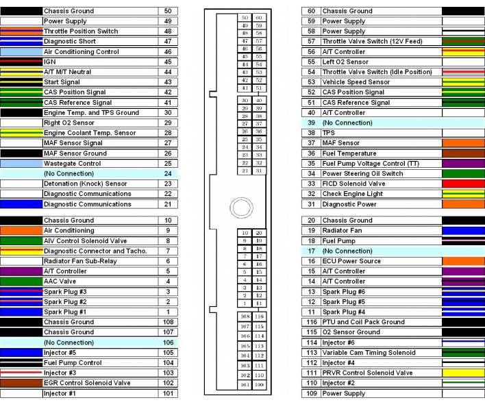

Note:Pin 44 on the engine ecu is for the neutral switch not the reverse switch,you can pick up the reverse signal under the bonnet or at the reverse light itself but the easiest is at the ecu for the autobox: pin no 20 have attached a pin out for you below.
Jeff TT
Engine ecu pin out for anyone wanting it

Pin 20 is an earth signal, the 12v power to the reverse lights is ignition switched so if you do need a switched 12v signal supply that will not help, however if you just want the camera to power up when in reverse rather than the camera be triggered then you can pick up any 12v supply and use the pin 20 to switch the camera on/off.

So with the info you have, wire camera up as diagram 1 and wire the reverse wire of the head unit to pin 20 on the auto ecu as Jeff posted and job done.
