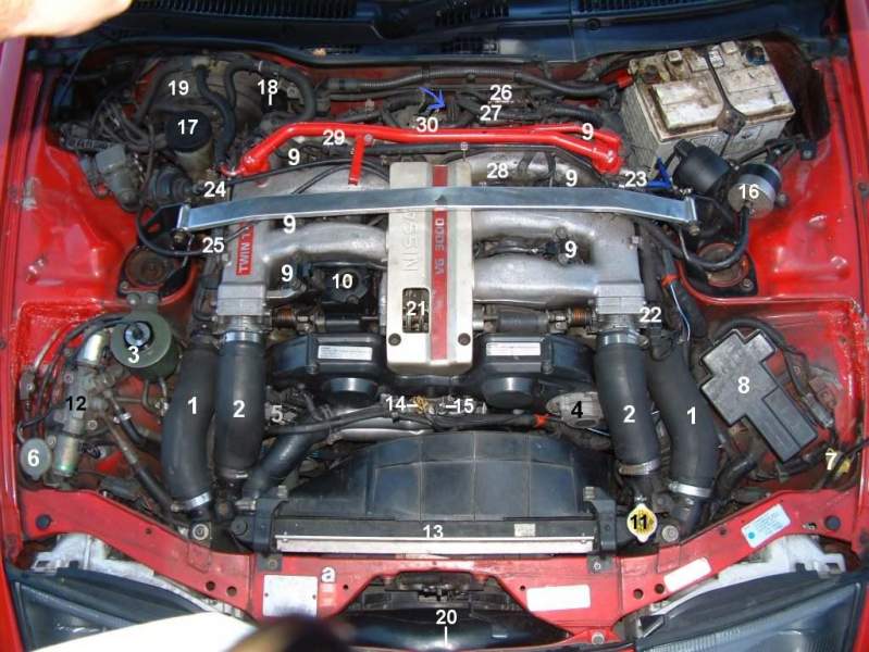

Number 30 with blue arrow
It runs down into the engine and is a right arse to get to with the engine in place which is why most, including me bypass.
ideal :) do you have a full legend for this picture?
also is it best to bypass it just above the engine on the loom or is there an easier place?
perfect :) i will be trying this on sunday when i next work on the car, still got to sort floor welding,new sound proofing, repair interior just for the water ingress damage :/, oh well get there eventually :)
