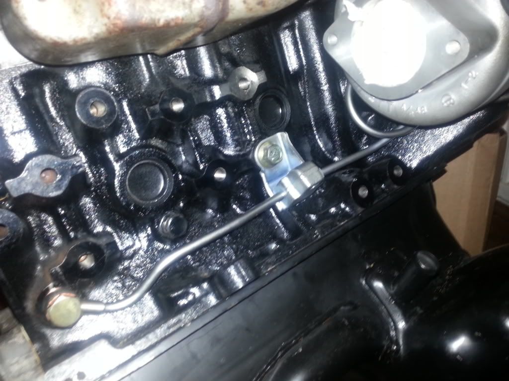

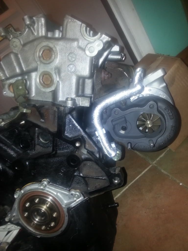

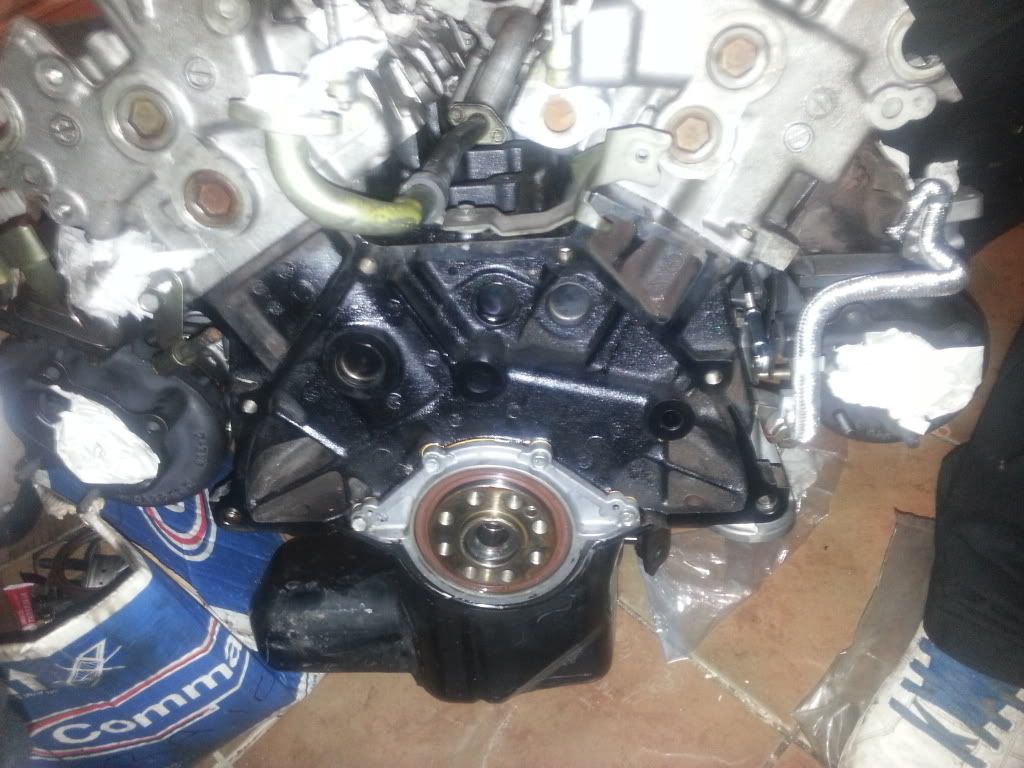

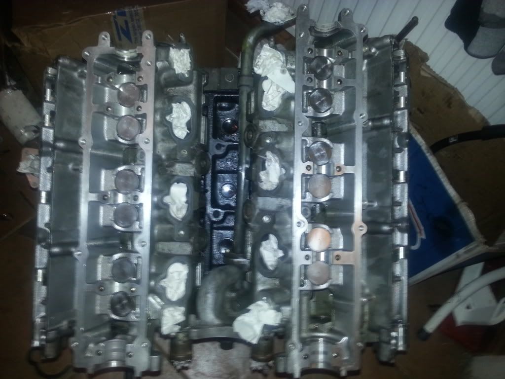

Hi guys has above helping oobumblebeoo with his engine rebuild,
Just wanted a bit of advice, stripped all 24 of the hydraulic lifters cleaned and rebuilt them done this to lots of other cars but mainly 4pots that if there was a problem could strip it back down in no time,
But being a zed not that easy lol,
Normally id just use tiny smear of oil or lube so there not dry put it back together and let it build its oil up incase I put to much in and end up with valves staying open.
Anyone built the lifters or know if thats wrong to do on a zed..
All the rest has gone well, changed all the stem seals, re ground all the valves what a mission 24 of the buggers..
Put his new 525 turbos on and new oil feeds..
Misses wants to kill me cause done it in the kitchen, bit cleaner then my garage.
Well incase oobumblebeoo is reading a couple of pics for him to see..
Any help appreciated. .
