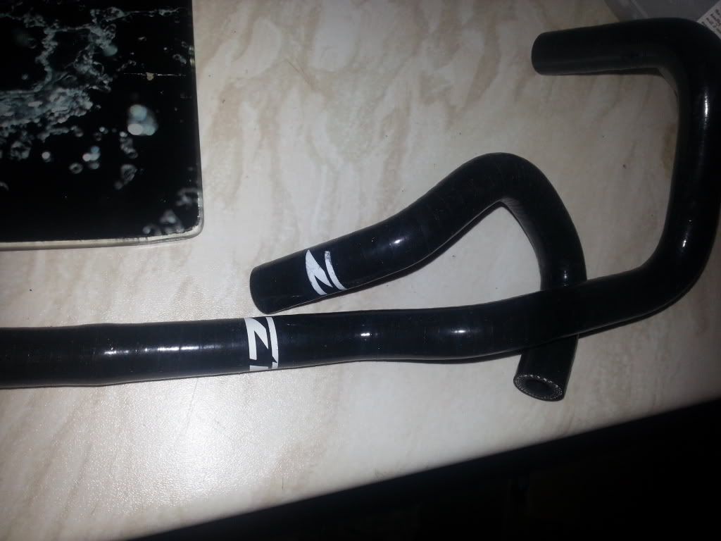

Mark would u know what these are for seems they came with turbos, water would need 4 pipes, had new oil feeds.
They are water pipes .. small one looks close to the drivers side ... Will check tomorrow
Think I worked it out he bought an oil cooler, I'll check with him tomorrow if he bought it from z1 look like the ones for oil cooler on z1 website.
Deffo new cooler pipes for the front.

Yeah worked pipes out, this is what happens when that oobumblebeoo keeps dropping boxes of expensive bits to me lol..
