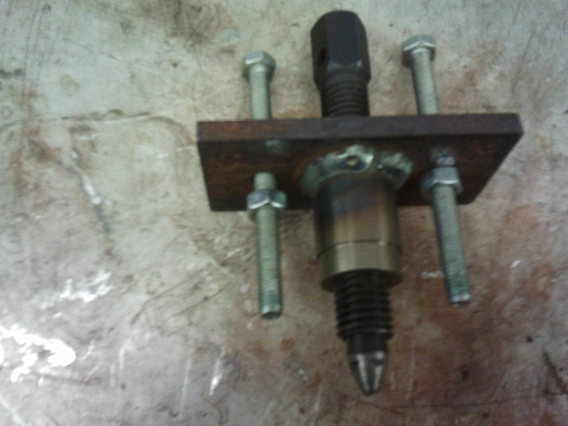

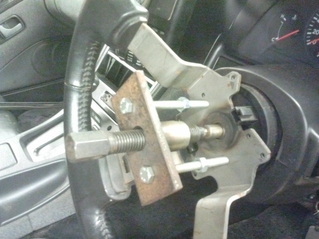

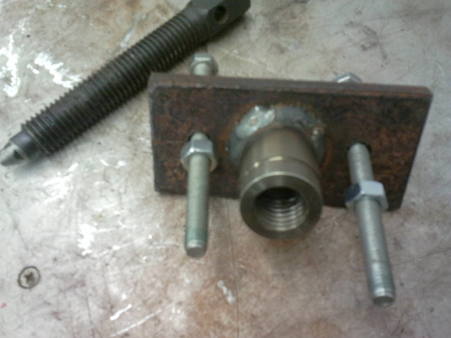

I did today and thought ime not going to break summit so i knocked up this puller...The OEM wheel has 2 8mm threaded holes for it seems a Nissan tool so after making the puller a firm tap on the centre threaded rod and off she came. Iff anyone would like a loan of it then just let me know but i must get it back so someone else in the club can use it and maybe we can all stop posting "i cant get my wheel off":D
