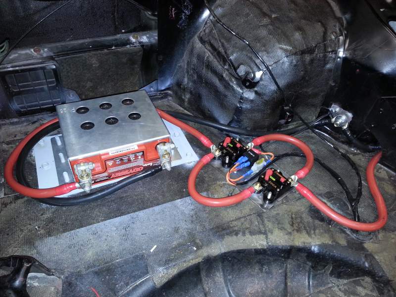

Hi all finally completed the battery relocation today using 2 resettable breakers instead of fuses for convenience plus deleting the now not needed fuel ecu and running an in line fuse and relay instead. We left the battery cables with some extra length incase I need to fit an normal battery at anytime as a back up.
what type of batt is that mate?:confused: looks a good install
Oddesay 25 racing battery...Thanks was all about making it secure and getting the earths correct
