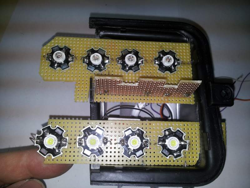

Anyway, sick of not being able to see at night when reversing I decided to do something about it today
First of all I used four x 3 Watt white LEDs and put two each side. I used some resistors I had lying around (rather than buying some wirewound ones) I used 22 ohm resistors, six in parallel then another six in parallel to give a total resistance of about 8 ohms. They dissipate quite a bit of heat! I would suggest if anyone wants to build a similar circuit you just by a couple of power resistors instead

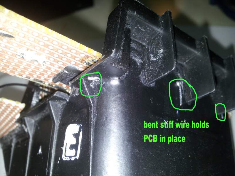

The pics tell the story well.... so here goes. The little bits of wire sticking out from each end of the veroboard are purely there to physically mount it in the reversing light enclosure

no probs m8, What about a wee Dab of hot melt glue to hold the Board, instead of the wire? just a thought.

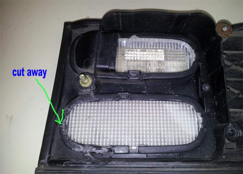

The one nearest the camera is the top/fog and you can see the leds sit right up to the lens as the board is clearly proud and just to secure I put just a few blobs of hot glue here and there, I did put some black tape around to stop bleed but I removed this to photo. This is the chamber that the black plastic needs removing, it will not fit under or in otherwise.
The reverse pcb does fit flush or better and the leds sit slightly away from the panel lens, this board needs less securing.
The OEM bulb chambers are not used.
The leds are alll visible when off and are certainly all visible when on.
