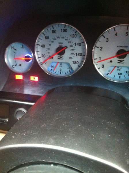

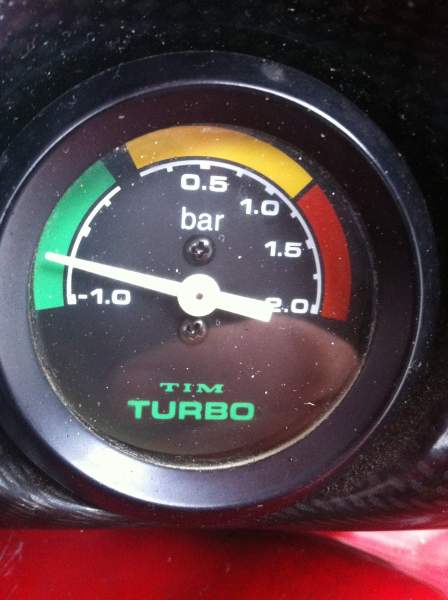

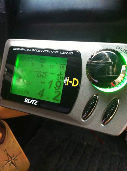

which gauge is telling porkies! boost problem
right i have my suspicions about the accuracy of the boost controller.
i check by using a mechanical boost gauge,stock boost gauge and the controller itself.
under boost the boost controller max's out at 5.6 psi the stock gauge goes up to where 9 psi should be......
this is really starting to piss me off as i dont know what to believe!

Not sure about your question above, sounds about right though. I had a similar problem as you, boost controller giving a different reading to my greedy boost guage and stock gauge. Stock gauge is rarely accurate anyway. On mine it was the boost sensor for the boost controller (greedy e-01). The sensor was faulty, which made the boost controller do strange things. The thing that lead me to the conclusion was when i turned the engine off, but didnt turn the key all the way off. The greedy boost gauge slowly rose to 0, as did the stock gauge, and the boost controller rose to -6psi, with the engine off. Tried all the above sujestions, boost leak, loose pipes, changing location of sensors etc.
Not saying this is your problem, but worth trying. Maybe see if someone locally has the same boost controller and try their sensor.

Thanks for the reply, i did check that when i turned the engine off last the boost controller gradually went up to 0 , none of my local z pals have a boost controller unfortunately, i have finished my boost leak tedter now so am gonna check it over the next couple of days, failing any positive conclusion i want to take her to jeff if he can squeeze her in one weekend soonish
Right update from recent testing
Checked for boost leak, found 2 the system now holds psi
Settings
channel 1 38% boost ratio gain 8 gives 9 psi boost
Channel 2 47% boost ratio gain 8 gives 10.7 psi boost
Compaired to what I was getting
(15 ratio boost 5 gain and got 6 psi
30 ratio boost 5 gain and got 6.6 psi
40 ratio boost 5 gain and got 7.6 psi
50 ratio boost 5 gain and got 9.3 psi
55 ratio boost 5 gain and got 10.2 psi)
Boost controler guage is the one to beleave [EBC digital readout].Nissan guages are renowned to be wrong. That includes OEM,speedo, tacho,oil pressure,fuel & temp guages.uselly read fast or slightelly high.OK for a quick referance to what is going on. Thats why after market Lab Instrument quality guages & race quality guages cost a mint.

i would turn your gain up as well ... IE for 9psi + gain should be around 15>20
