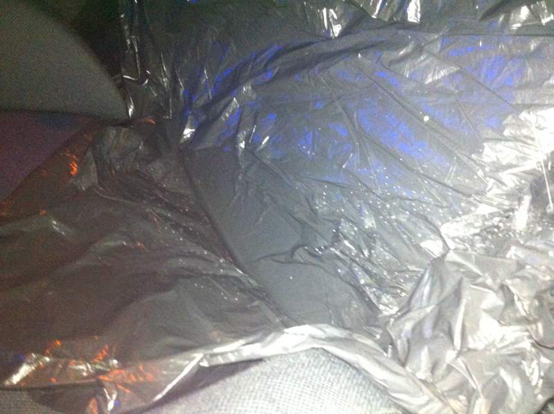

i think my leak is different, cant explain it but ill try, ive resealed as per jeffs thread, but its still leaking in the same place ive just been out to the car, the rear seal isnt leaking but the front one is (going by jeffs thread on this)
but it seems to be coming in from the targa side of the trim, if that makes sense. ive checked the nissan post groover put up, but doesnt seem to give an idea of where the water comes from unless im looking at that diagram wrong.
i know one thing though, im glad ive used a black bin liner on the drivers seat. or im sure it would be a puddle in the rear of the car about 4inches deep.
Not sure how well you can see how much water is on this, but glad i checked when i did it was almost overflowing. and this was from just one night and a half day or rain.

good luck, ive sealed all the parts that jeff mentioned in his post, i still have a puddle on my plastic bag and its still leaking up near join between targa and A pillar, so my leak is somewhere else, as it now no longer fills my gauges up. i have a feeling mine is now leaking from the targa side of things, but i need to figure out how.
