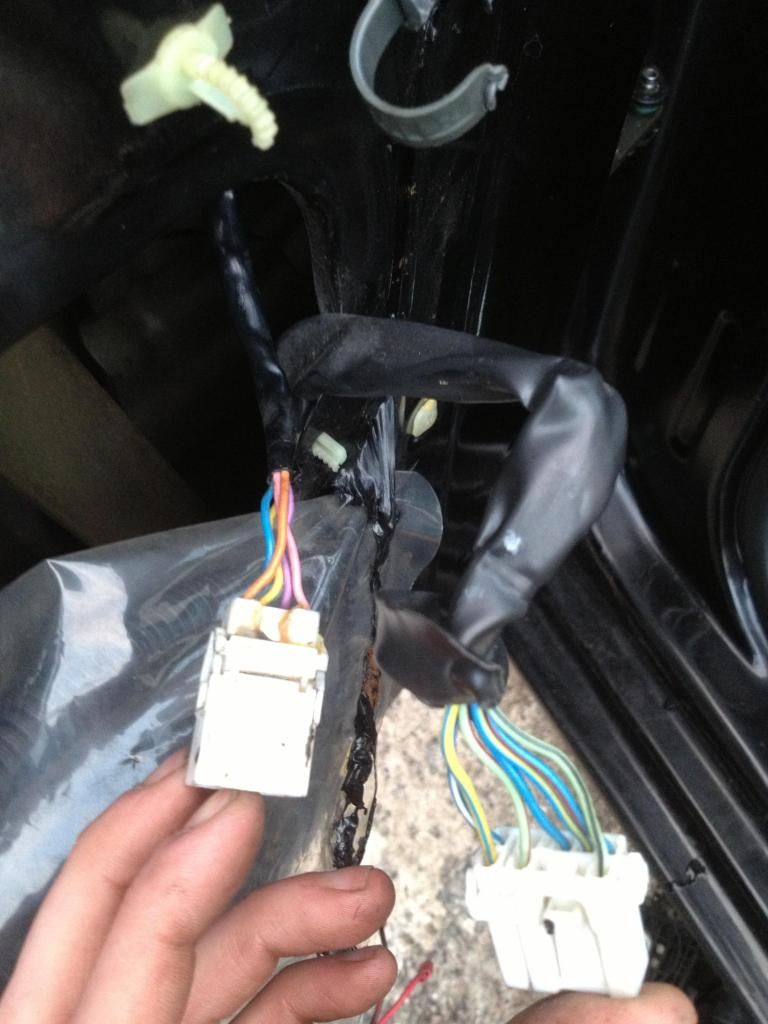

I've finally got round to fitting my replacement wing mirror but i need a bit of help wiring it up.
The problem is the old wing mirror had a 7 pin plug and the new has a 5 pin plug (old was heated, new isnt)
I've taken a pic of the plugs and wires, can anyone tell me which wires need to be joined together because i have no idea :p

In your pic and looking at the 7 pin car plug the yellow/blue and blue/white which are together at one end are the heated two wires, so if you ever bought a heated glass run two wires from these to it.
Looking at yours and my pics it looks to me like
orange goes to green/black
I cannot make out the colours as they all look blueish on the car plug but adjacent to the green/black wire this is where you connect the blue wire from mirror, then one down is the yellow and down again is the purple.
pink to green/red
Write down and post what goes where as I am sure others will need it :thumbup1:

Thanks a lot mate, I'll give it a go when the bloody rain stops!

I know this reply is a while in coming but I've seen similar queries and enough is enough I am writing this down !!
Mine is a J Spec so I have the full compliment of 7 wires at each mirror.
This is my drivers side, colour first in each case below is the mirror wire
Orange connects to Green/Black
Blue to Blue/Orange
Yellow to Blue/Black
Purple to Blue
Pink to Green/Red
Black to Yellow/Blue
Black to Blue/White
I know the final two blacks from the mirror are for the heated glass part, note both blacks are the same colour and so if you flip flopped them it wouldn't matter.
Not sure if all imports are the same but my passenger side as some slight differences, so please note carefully as the Blue and the Yellow mirror coloured wires below go to different coloured wires than the ones on the drivers side
Blue to Blue/Red
Yellow to Blue/Yellow
Purple to Blue
Pink to Green/Red
Black to Blue/White
