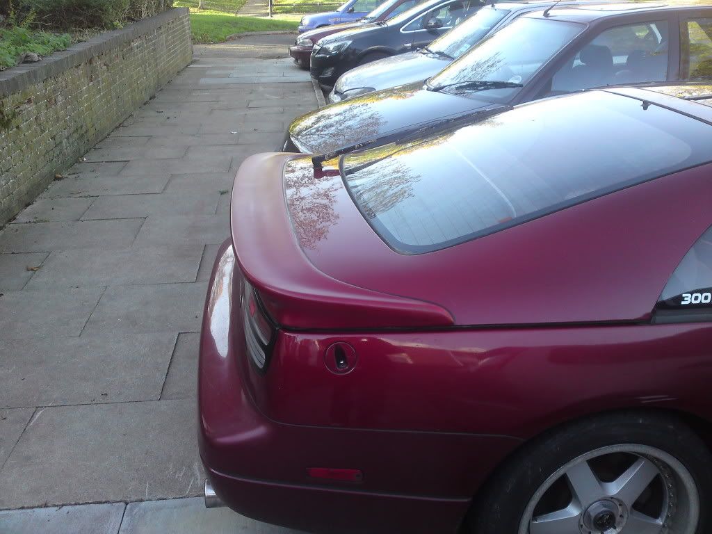

i did my 99spec front bumper using 3 cans of colour spray 3 cans of lacquer, and that came out great, nothing wrong with using mixed cans of spray from halfords, its the lacquer that offers the protection, if it gets through the lacquer doesnt matter what spray you used for the colour its going to take damage eventually
Halfords can spray the colour if they have the paint code on there system, ive had nissan diamond black mixed (the spoiler at the top), bay-side blue mixed and also AH3 (nissan cherry red) for my 99spec front bumper and 89spec spoiler, all have come out near perfect matches.
rear 89 spec spoiler, sprayed with halfords AH3 before lacquer
front 99spec bumper sprayed with halfords AH3
