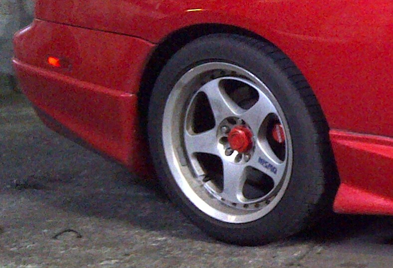

**While I am at it** anyone got tips on Refurbing Rims??
Temptation to Keep my Nismo's for a bit longer and get them nice and shiny. then in May/June look for a new set..

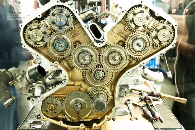

and Just had a thought of what would happen if this was the case with Zed timing...
[ATTACH=CONFIG]67597[/ATTACH]
looks to me in that pic ... middle left idle gear has had bearing collapsed
plus stripped teeth on bottom sprocket
regarding timing on that engine it would be just as easy
Long as the bottom timing mark and the cams was aligned the
idlers sprockets between it doesn't make any different
Long as the bottom timing mark and the cams was alight the
Well spotted Mark.
indeed what happened to this V12 Ferrari engine :)
