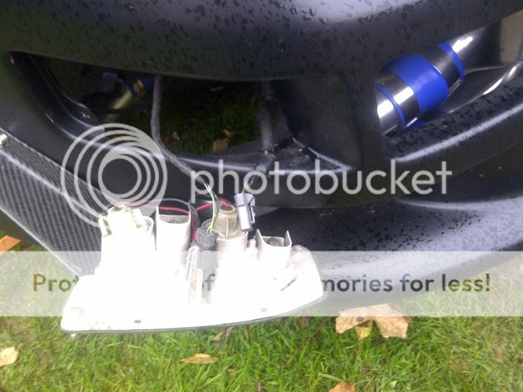

all of the 10amp fuses in the drivers footwell are good, however there is no power going to the connection where the HIDs plug in (see pic)

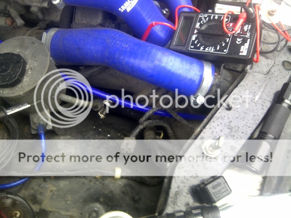

My full beam stayed on when a fuse in the engine bay popped, at 1st didn't look like it but it was.
It was in the little straight fuse box up at the master cylinder area.

then I popped the bonnet and this little ****er was staring back at me!
