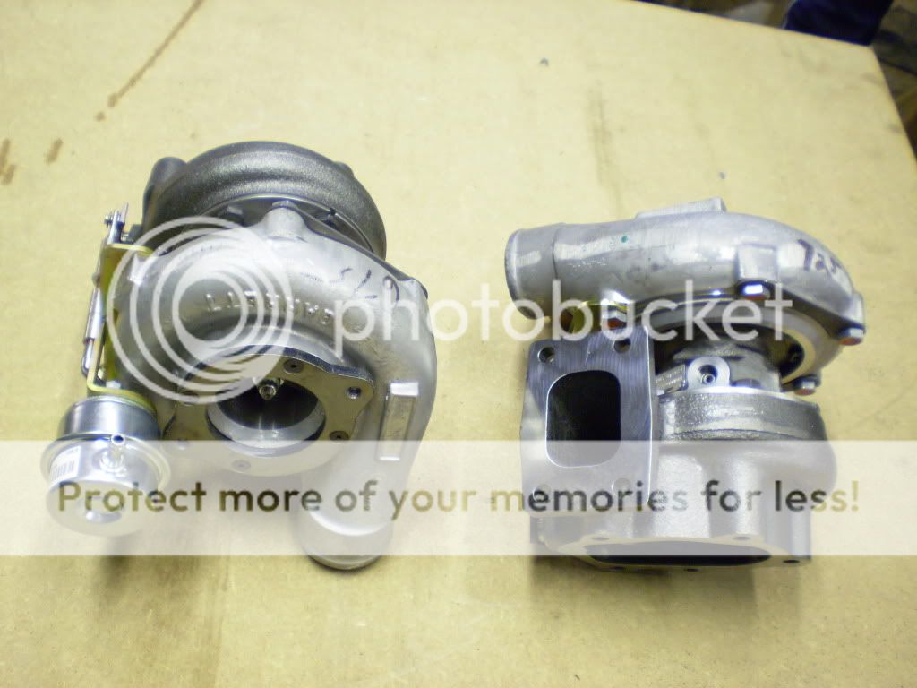

i can not see how he could say they fit a 300zx ... as they havent even been fitted for Left/Right sides
they look like Godspeed tubs or Chinese type ... and like u pointed out Cheap and could blow at 1k
and with the 300 ... its engine out do u want to risk it
out of interest what did u pay for them ?
Well i bought them used but brand new and paid only £315!! I asked are they garrett and will they fit my car and seller answered yes! but lesson learnt
Silly mistak really but there we go, my car has been really well looked after since import in 1999 so i'm not about to go cheapy cheap on it
by the size of the tub yes they would fit ... its about the largest u can go with out really hacking out Car chassis and other parts ...
Other than that they wasnt Made with the 300 in mind due to
Clocking
Vac tap
Actuator Placement ( Brackets )
Pipe work Fitment
Exhaust outlet 5 bolt

If you mean the pics of turbos that I posted mate, they are Garrett GT675RS roller bearing turbos from Z1 in the States and are sat on my work bench at the moment staring lovingly at a forged lump on an engine stand...
I posted the pics to show what I was trying to explain about the inlet adaptor plate that can be rotated, rather than just two drilled bolt holes in the housing the plate has several small allen/hex bolts so that the plate can be relocated to adjust the rotation of the housing
