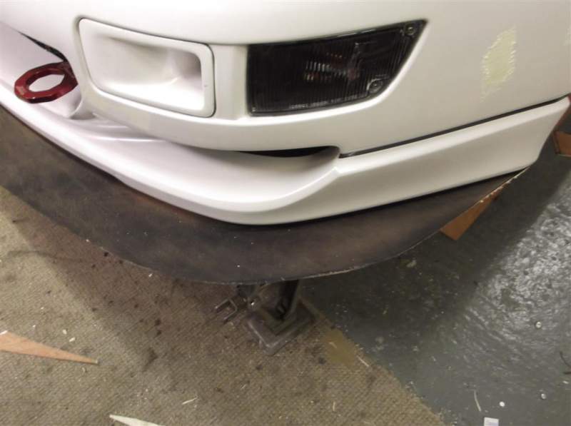

Does the splitter need to be so thin Pete?? if you could run with say 15-18mm then cut it out of foam and just glass it up...Super strong and rigid and very light too.
Are you ever :tt2:
I doubt fiberglass with woven in it will work. Not at the the speed bobs car can go. you will get to much flex and will proberly fail. you could get it to work but it would start to weigh some so aluminium would be best i would say
As always Im listening to those who have relevant experience.
The honest answer is... I dont know.
Bob and me have no previous experience in this area. We have looked at other Time Attack cars and done some further internet research.
I "think" it needs to be thin to split the air smoothly. Its not a spoiler.
We are going to do this first one in the ally sheet we already have.
Then we need to see if it feels good in testing.
If so Bob has a contact for re doing one in Kevlar.
If not then it will be back to the drawing board early next year.

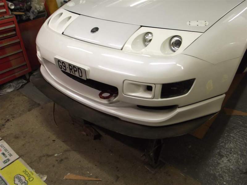

As said already Bob is picking the car up next weekend so I haven't a lot of time left to tidy up and finish off the work in hand.

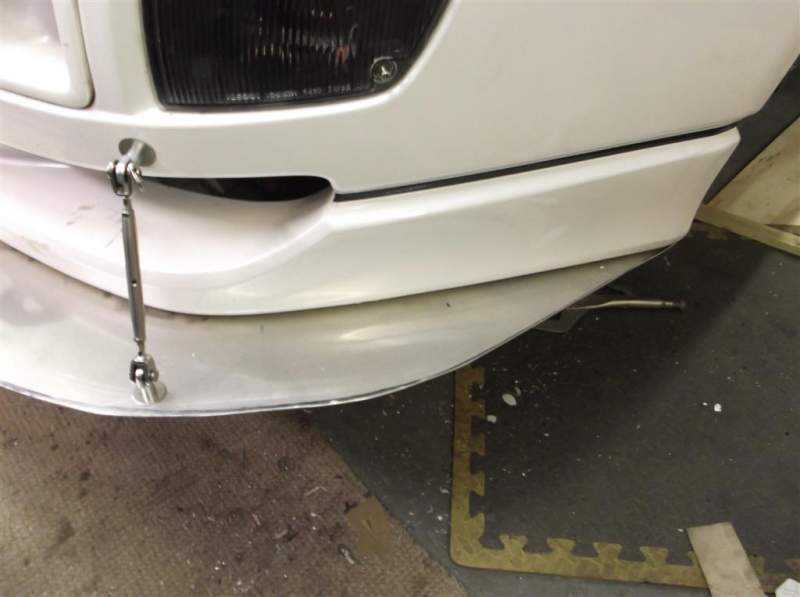

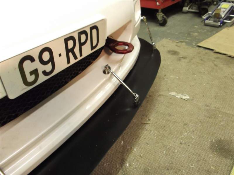

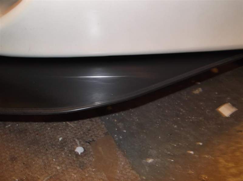

Splitter.... Mk2.
Less extreme.
We think this is the one to go to ally with now.
That should be fun:blink:
Just a thought would the splitter be to sharp? are there any rules?? maybe some rubber edgeing strip?
see previous post.:biggrin:
Its not pedestrian safe/friendly but the car doesnt get driven on the road nowadays so its fine.
Fitting some edging temporary will get it thru an MOT... or just unbolt it.It will all be easily removable single handed for mainteance/emergency pit access.
Quote Originally Posted by Car.Mad View Post
We have decided to add some thin edging to WE dont catch it ourselves on the shins!!!

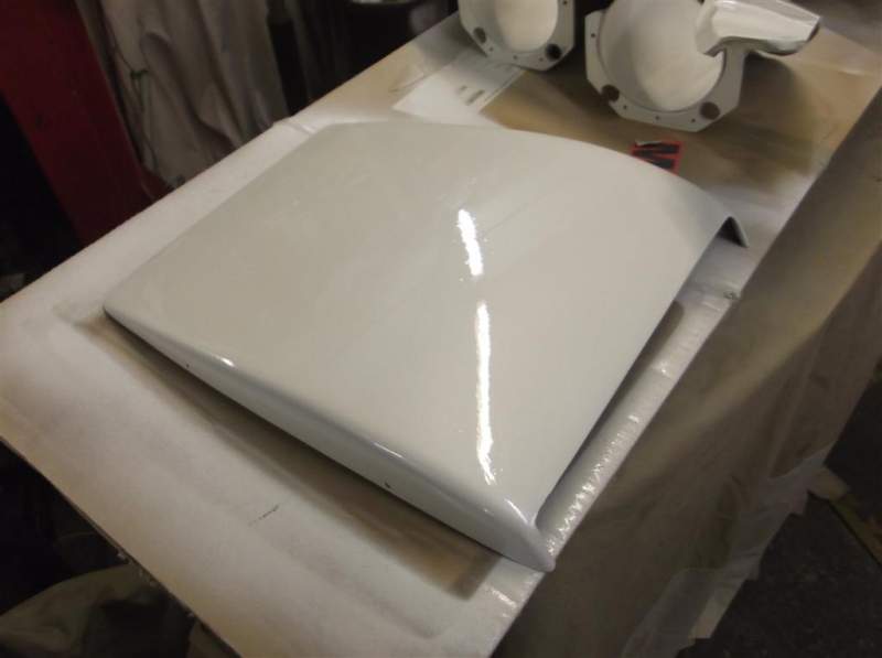

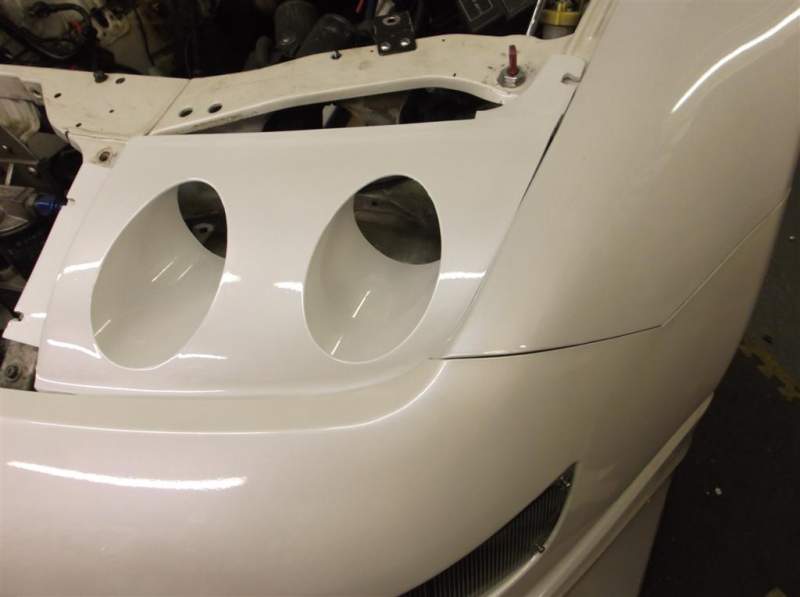

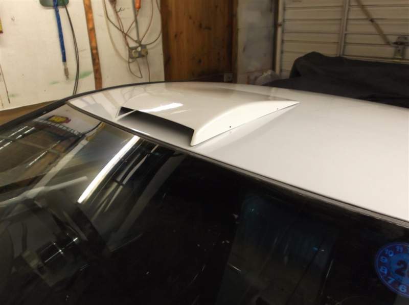

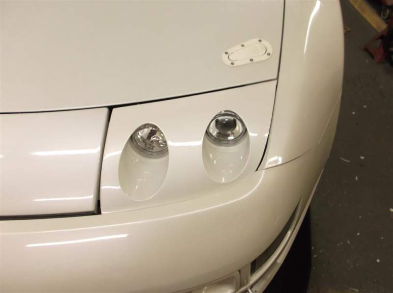

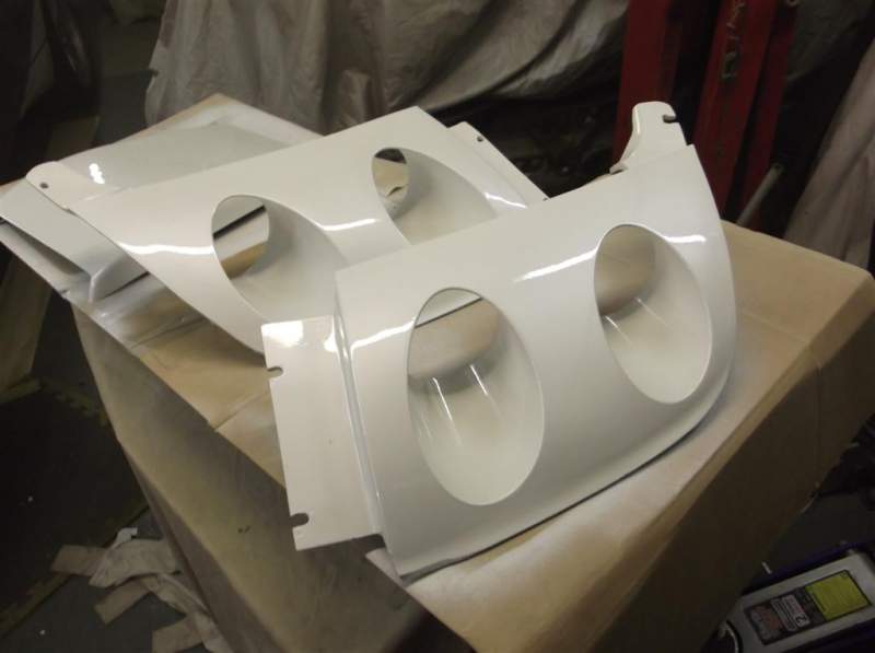

So on to todays work....
Just a little white paint to throw on, that wont take long eh???
WRONG. Its pearl white . My nemesis in the paint world.
So step 1. rub down headlamps and 2nd hand roof vent.
step 2. degrease with panel wipe.
step 3. Paint with 2pack white primer
step 4. then paint with white basecoat.
step 5. paint with pearl basecoat.
step 6. finish with 2pac clear coat.
Result.. perfect... well not quite.. I put a little too much pearl of the roof scoop so it looks a little off shade.
The problem with pearl whie is it takes differently on fibreglass and urethane panels to metal.
So for an amateur like me getting it 100% is almost impossible.
Since most people will see the roof scoop overtaking them at 100mph I can live with a little shading variation.

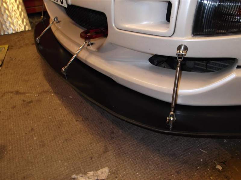

While that lot is hardening off overnite i had a little play with the first splitter support rod.
Looks like another scary job looming when I have to cut a hole in the slicktop roof.
Probably measure THREE times and cut once! LOL!
Anyway enough chat... here are the pics... enjoy.

[ATTACH=CONFIG]67624[/ATTACH][ATTACH=CONFIG]67625[/ATTACH][ATTACH=CONFIG]67626[/ATTACH][ATTACH=CONFIG]67627[/ATTACH][ATTACH=CONFIG]67628[/ATTACH]
Some nice work there Pete,just to give peeps an insight into splitters and their effect on the car,jaffas rear splitter is pulling his bumper fixings off at the sides it creates that much down force,see youve gone for braces Pete,should hold it on nicely,may have to look at something along those lines for James in the future.
Ere Jimmer, he must still be getting some parachute effect on his rear bumper getting above the diffuser and pulling it down as the diffuser won't be causing downforce. (Queue open can of worms!)
As the air flows under the car, its pressure drops to create a downforce, this needs to peak at the red wheels but the it needs to be dumped. If you have lots of downforce at the breakaway point at the rear the air will be turbulent and cause drag. The diffuser should, just after the rear wheels, increase the air pressure and slow down the airflow speed (diffusion) and effectively cause lift in that area. The design principle is mainly to slow down the airflow as much as possible so that when it breaks away and exits the airflow under the car, it matches the ambient air velocity/pressure around it and in turn (the target outcome) reduces the drag at the back end.
I hope I don't sound like too much of a toffee nose tvvat but its all interesting stuff I suppose! I know the principles but I cannot tell you what the results are likely to be in terms of performance, handling gains, I think Dave, legrath, is the man to ask about that.
Rather than guessing I'd just give UAS a shout to see what they did with their zed for WTAC the other year, because at the end of the day bad aero can have a huge detrimental effect on performance.
I thinks that's probably quite accurate, when your weight saving grams at a time I think the aerodynamic benefits from a good setup would be the same as adding lightness! But when it comes down to lap times in the real world without extensive testing in a wind tunnel I have no idea lol. It will no doubt be fun playing around with different setups though.
An extreme example maybe but I suppose when you consider the huge flap on that F1 engineers get when a small portion of rear diffuser or front wing gets detached during a minor prang during a Grand Prix, and the detrimental effect on stability that's reported by the driver as a result, you can see that aero harmony is quite important in the grand scheme of things

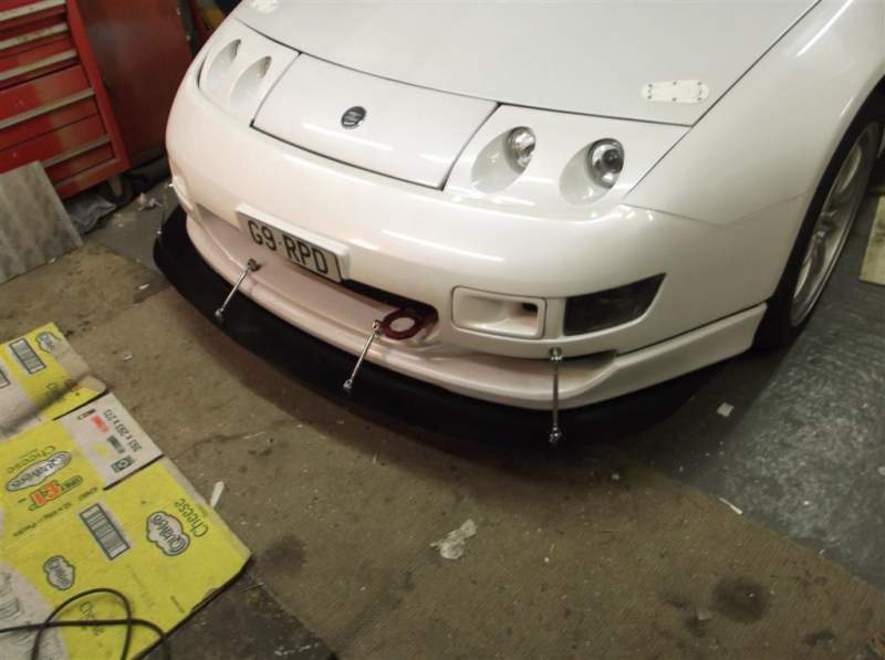

So a long day today and a big push to get this work finished for the weekend.
I dont normally go back out after dinner but tonite I did to get the splitter/undertray finished.
Earlier in the day I re assembled the painted headlights and fitted them in the shell properly.
The look is growing on me but Im pleased that following a few calculations the whole splitter /undertay weight is only slightly above the weight saving on these headlights.
Just the roof vent to go then...........
