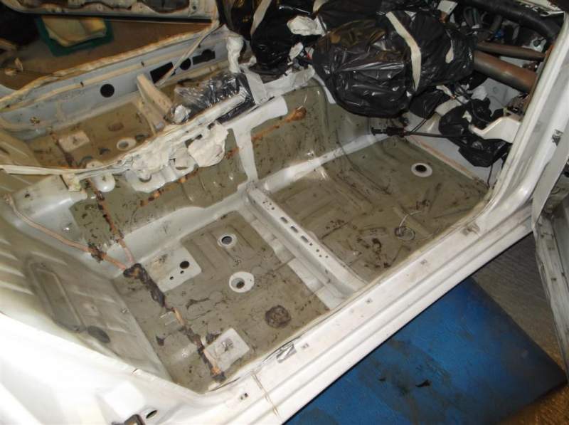

In that photo of removed stuff there is over 16kg

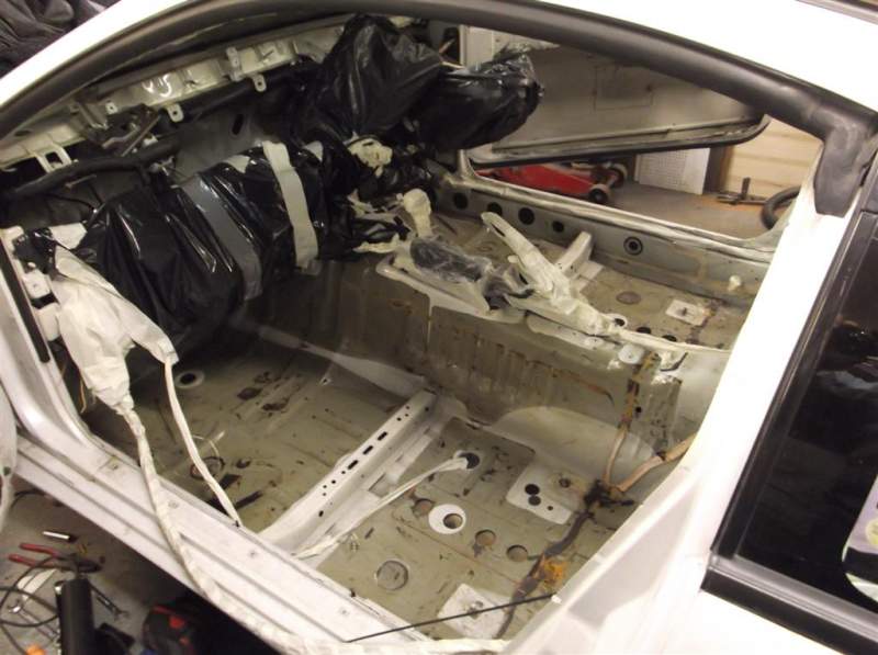

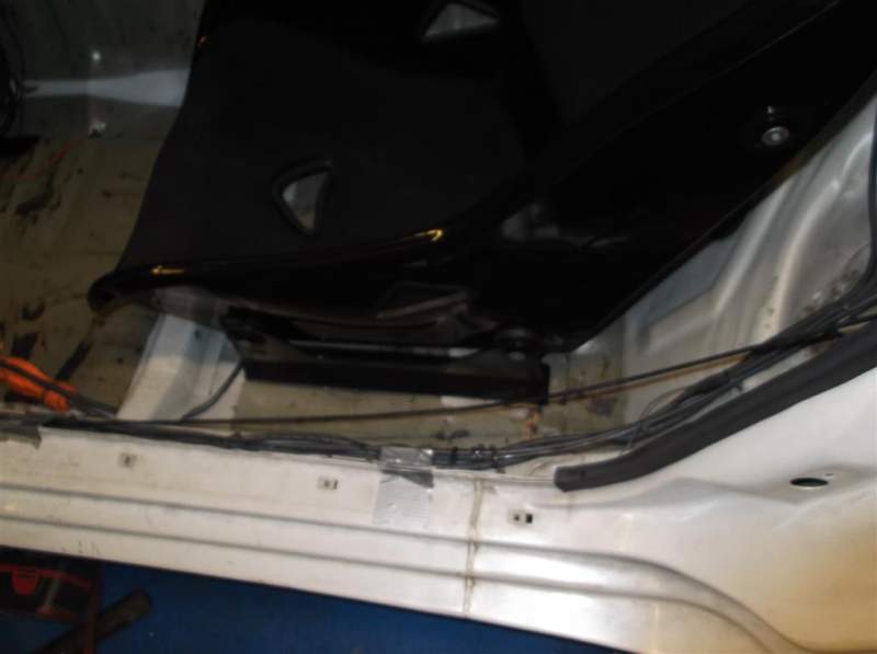

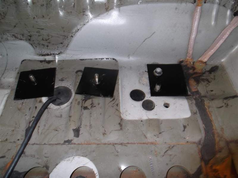

Well today I have spent a long time fitting the passenger seat (then removing it... LOL!)
I have used one original rear mount. Then I made an adaptor plate to pick up on the other side.
Then I made two spreader plates for the new front mounts complete with captive bolts, so seat fitting and removal is easy and quick. Its quite ridiculous how much time this takes and how many times I have lifted that *****ng seat in and outta that shell:rant:
Before I even started on the fabrication I spent a little time finding the optimum position for it.:biggrin:
Once that was all done I trial fitted the footrest which will be needed as the seat is much further back than stock. It is also very low(but adjustable) This will keep the passenger out of the drivers line of sight and keep the centre of gravity low too.
Its as important as the drivers side to get the pass seat safely and securely mounted given the high speed and G forces generated inside this car on full chat.
Im very comfortable in there.:thumbup: Bob,s lovely partner Martina will be too.:kiss:

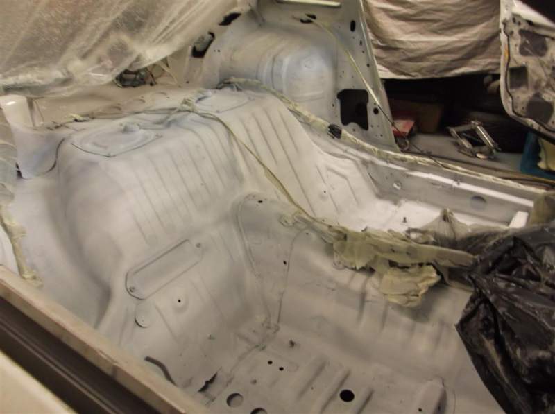

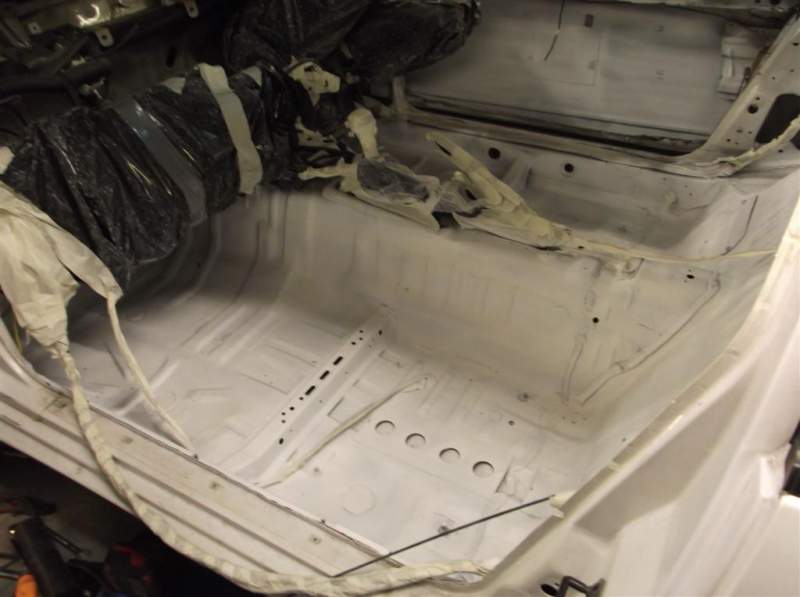

The rest of the day was spent doing the final de bracketing, panel wiping and masking inside in preparation for paint.
All in all a very long day.......:glare:
Pics......................

good progress. I remember fitting my seats, what a PIA!
PS you can remove the sensors that go out the floorpan under the seats, they are the cat overheat ones.
I already have:thumbup1:.................................
The wire you can see is the wideband sensor wire... I think:kiss:

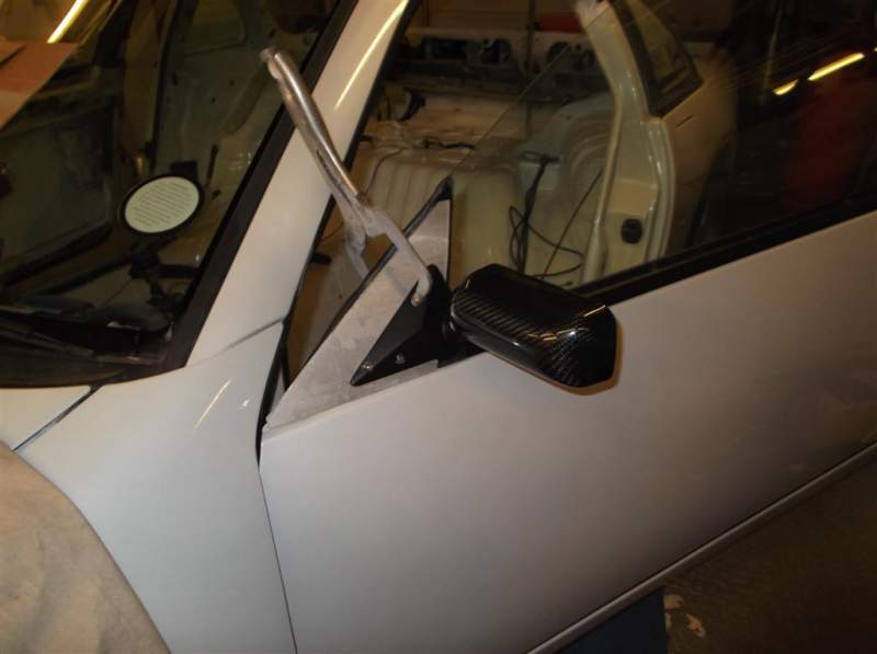

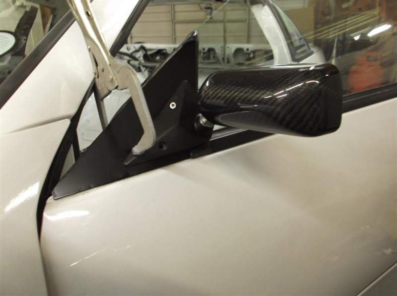

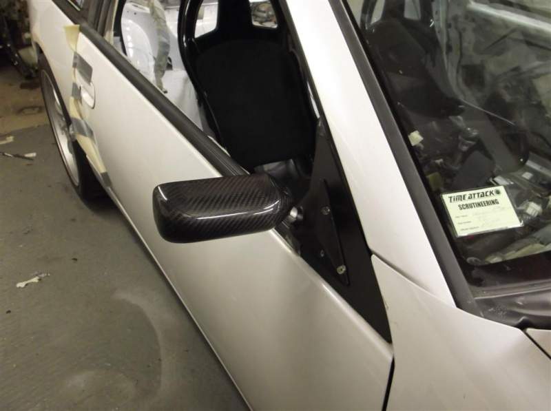

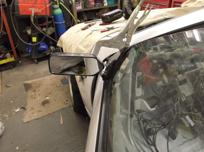

So........... today I have been trial fitting some mirrors and making some base plates.
These might look a little familiar Jaffa:laugh:
I have just sprayed the ally panel satin black. It would better using a piece of carbon fibre sheet but I dont have time to source some and cut it..... later maybe but for now these will do and I need to move on.

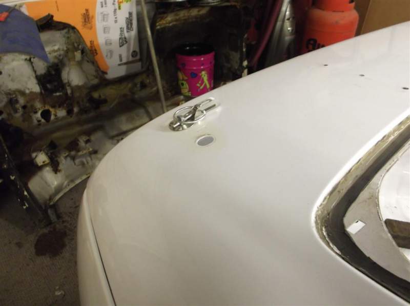

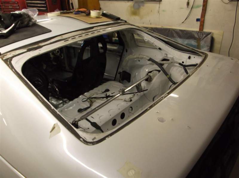

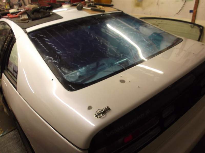

There are not many disassembly jobs left thank goodness. Rear window removal was one... Now done and glass in one piece.:sweatdrop:
I decided to use some of the existing holes in the tailgat to mount the retaining pins.
The nice 50mm setscrews to mount the door mirrors and their adaptor plates arrived today.... So I fitted a mirror.
i have also cut and rewelded the new wide view interior mirror and located it. I know carbon fibre is not everyones cuppa but IMO the mirrors look good AND they are very light.
Pics .....................................

Im now at a tricky stage with the tailgate. I need to bond the Polycarb window in place without removing it from the upper locating rail!!! Its not rigid like a piece of glass either.
I will only get one shot at it. If it drops in the wrong place there will be black sealant everywhere but the right place:glare:

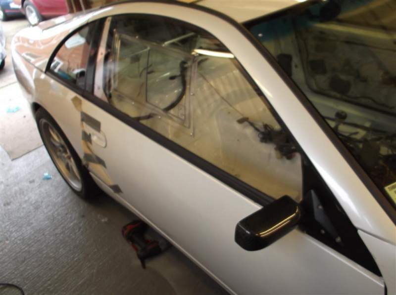

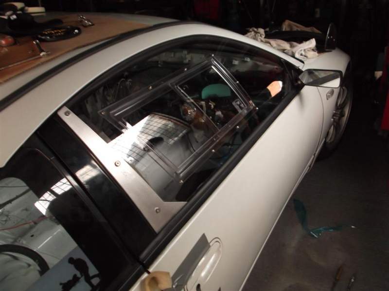

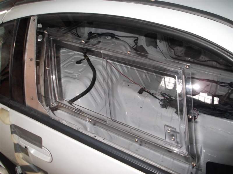

So in the absence of any helpers ATM I moved on to fitting the first side polycarb window.
Bob and me had discussed a preliminary "how to" method but I have been putting it off for a few days,given the cost and the timescale to get another one if it were to go pear shaped on me:blink:
Today was the day and although I dont normally do "excited" over project work Im feeling close to that tonite.
I know self praise is no praise at all BUT I think I have done a good job and IMO they look "the business".:yes:
Although I appreciate most of you wouldnt want them in your car.:biggrin:
Any judge for yourselves cos here are the pics............................
