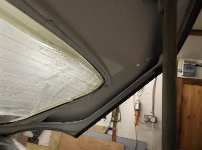

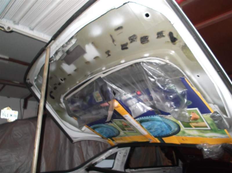

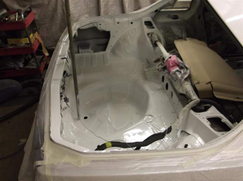

And so... after a week in Fuengirola sitting in the sun plus a day playing at Santa Pod its time to get on with this slicktop.
The process of removing sound deadening. De bracketing and lightening goes on... and on.....:sad:
However the hatchback area was completed yeasterday so I decided to take advantage of the mildish weather and get some paint on(with some extra heat required)
Its not very exciting and the pics are'nt either but its moving on....... I think:whistling:
When Im done the whole interior will be clean fresh white with no ugly brackets etc sticking up to catch on.

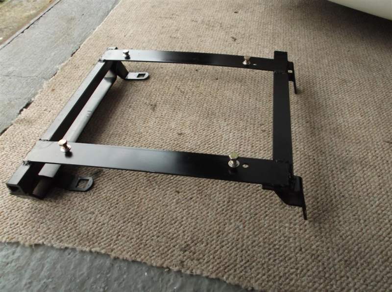

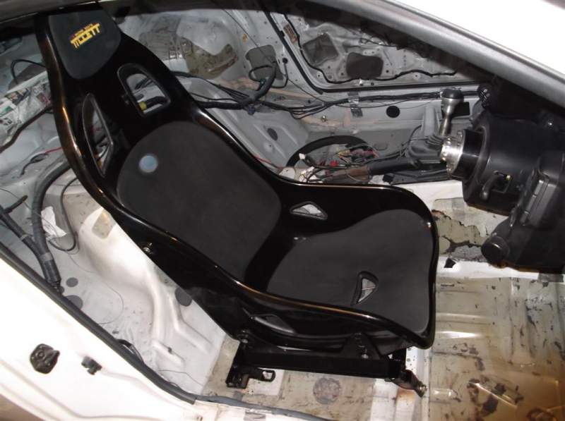

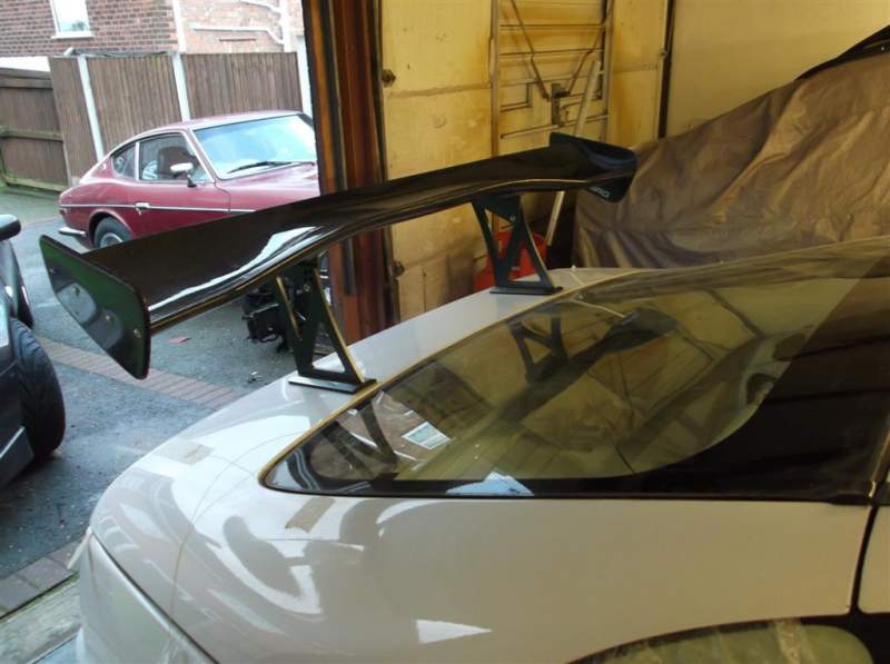

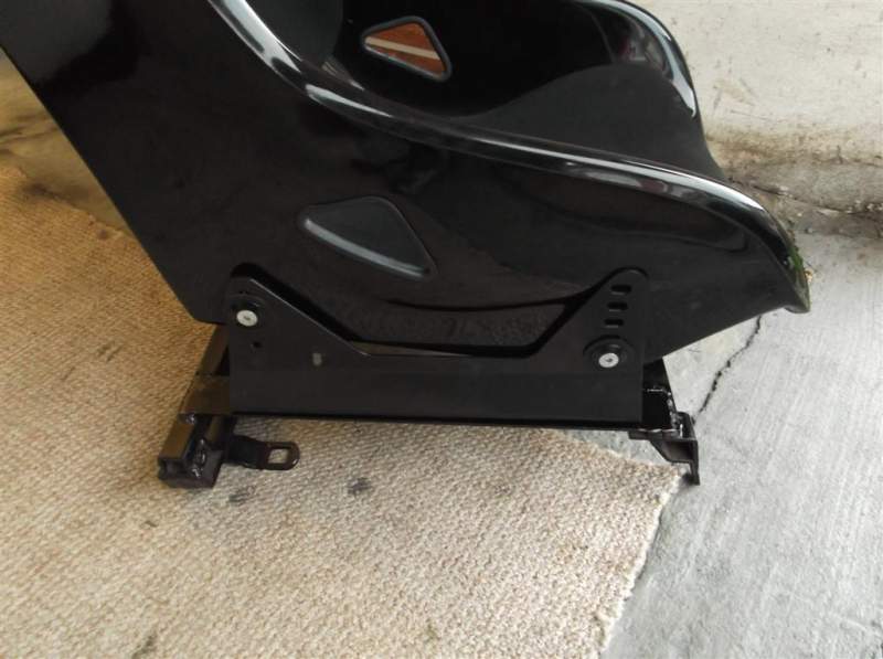

After a visit from Bob I have the final height etc on the seat mount so today I welded it up and painted it.

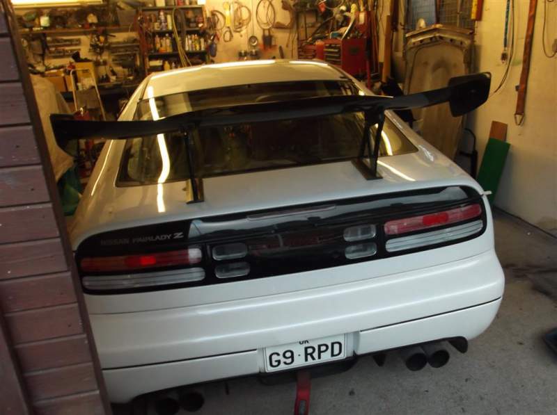

i have also had an initial fit of the Sard wing. With seat and wing in place I have now got a stem length for the rear view mirror sorted.
The seat and frame has taken some time to get done but it needs to be right first time as there wont be a second chance if it all goes pear shaped!!
Enjoy the pics and have a private snigger if you like over the wing.:blink:

i know that its function over fashion but jeeze that wing is ugly, it sits so high. looking good though, and im enjoying the subtle plate.

Love that rear wing. What make is it ?
:kiss::kiss:
Love that rear wing
well you can please some of the people some of.............etc etc:biggrin:

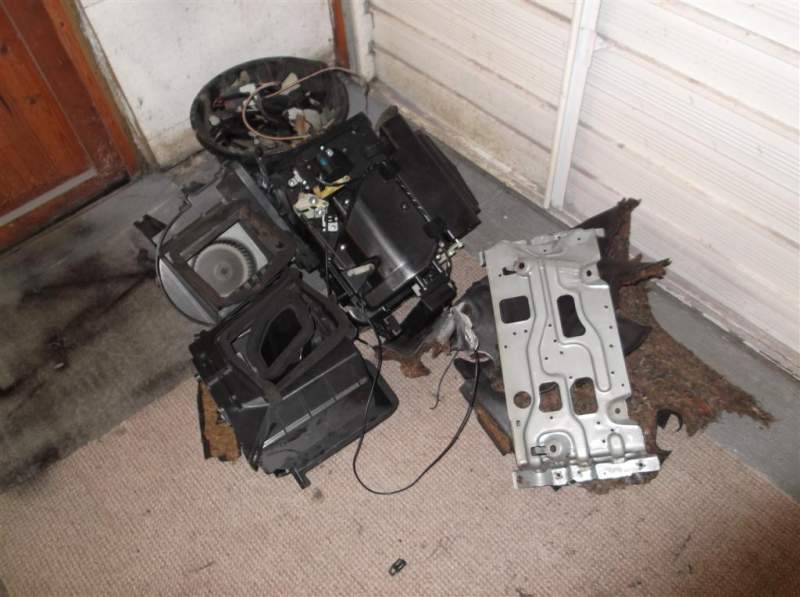

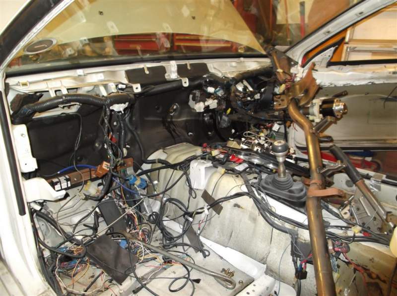

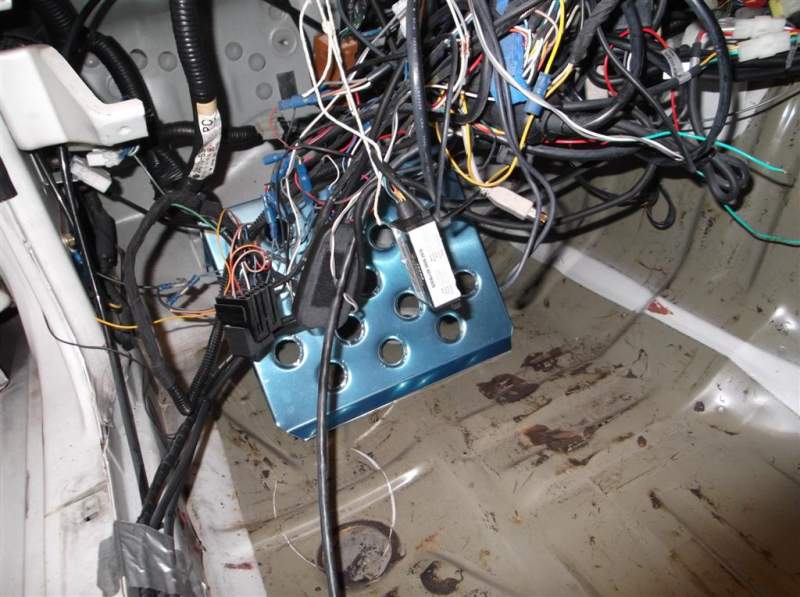

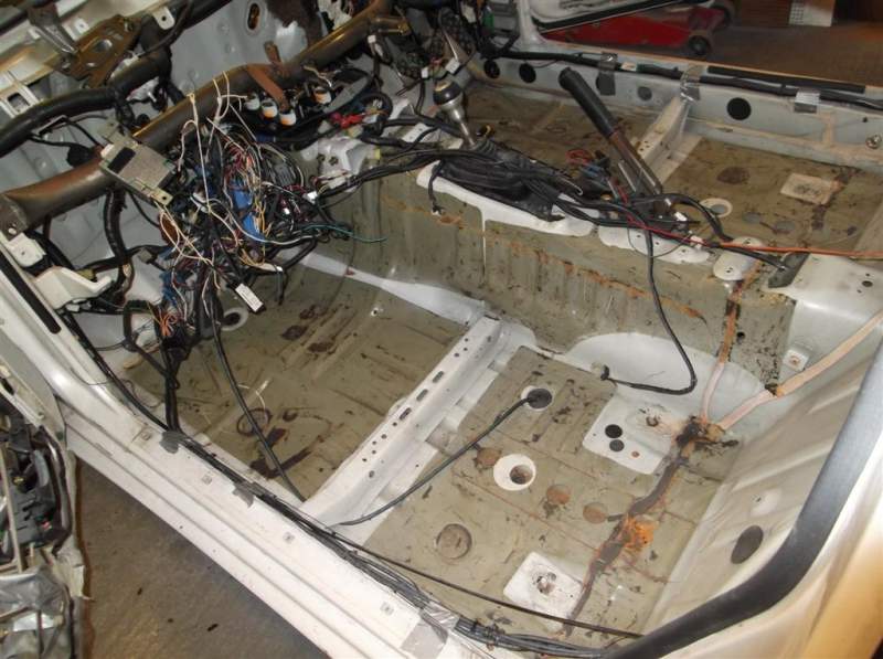

There is a time in most projects when you think "I should never have started this"
i think I was at that point yesterday as I stripped out the dash area to remove all the heater stuff.
LOl!
What a mess.

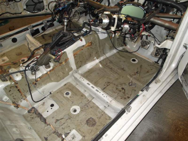

Then today with a couple more hours of effort I finally got all the sound deadening out and the floors ready for painting.

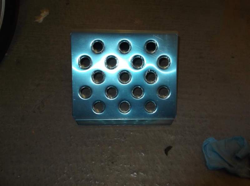

A couple of nice little trinkets turned up also to add to the "things to fit" list.
