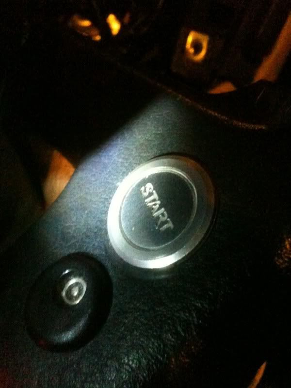

I want to get it working again so need help please.
This is the button

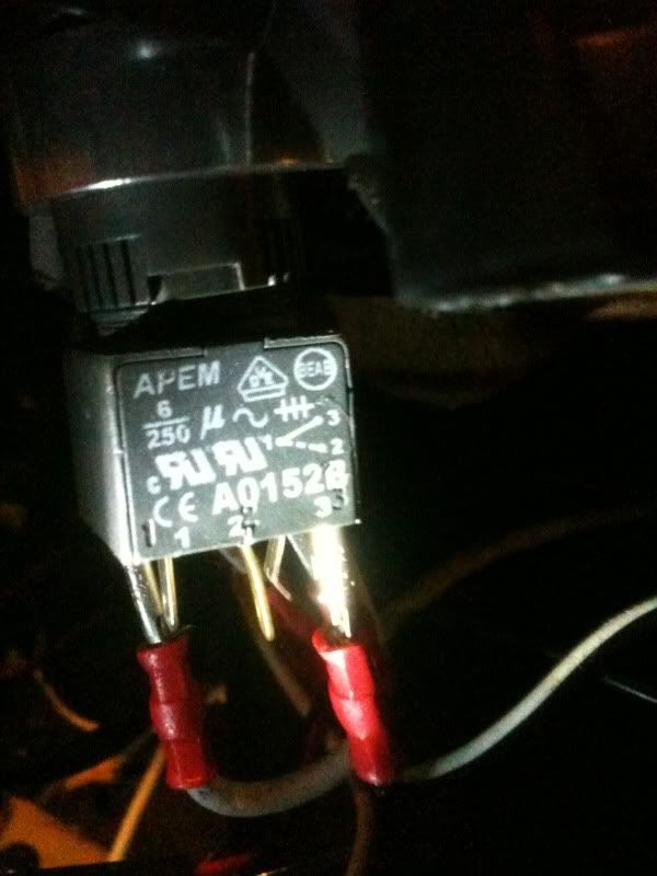

The back of it has 2 connections and it slots through a connector block which has 6 connections, so I have a total of 8 lol.
Anyone know what's what lol

From what i remember, you only need 2 wires, BUT here is the kicker, if you wired it to the ignitions wiring, you will still have to turn the key, then press the start button, other wise if you wire it up to start with out the key, anyone can start your car with out it.
Think if im not mistaken, you wire one side into the black with yellow strip wire, and the other into the white wire. then turn key to Acc and press the start button. pretty sure its that.
But before attempting to cut wires on your ignition barrel, might be a good idea to consult the zed bible first *service manual* just incase im wrong lol
It's definitely one where you turn the key first.

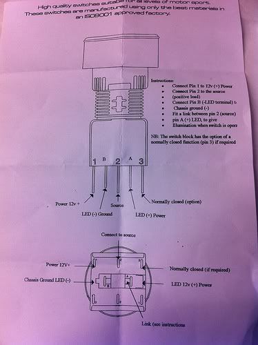

Lee - so do I only use one side of this connector? Like one set of 1, 2, 3? And how do I actually wire these and to what?
Also where do I wire the middle 2 that come through the block from the actual button?
I found this online somewhere:
