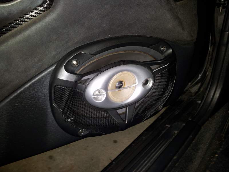

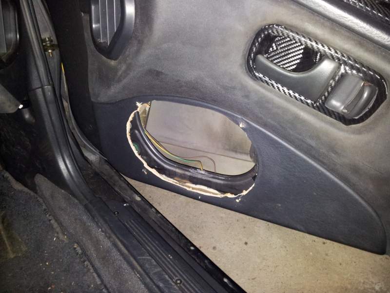

Pics below:
The first picture, the one that looks "normal" are of the speaker in the passenger door. This one seems to be ok and hasnt fallen out, even though the door obviously still has a massive hole cut in it. The others are of the drivers door and the said hole, just to show the rough size and what it looks like etc.
So, with this in mind, what do people reckon would be the best solution? As it happens I'll probably be getting some new speakers at some point anyway so don't worry too much about the size if I need some new housing etc...
You can put some slats of wood behind the panel to screw the speaker to, its seems the previous owner tried to screw it directly to the cardboard panel.

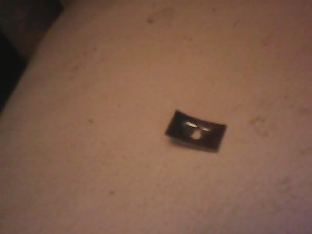

Had that problem with mine. I got some flat screw-in washers from Halfords that should hold it back on
sorry for the bad pic but my normal camera isn't working at the moment and I can't find a link on the Halfords website
So basically, the nuts in that link can just go on one side and the screws will just go into them and hold it in place?

Your basically after a clamping effect to hold the speaker onto the card, you wont be screwing to the metal on the door.
ah ok cool, thanks guys. Seems like it would be easier like that then making a grill or some sort of speaker boxes/housing...
I'll try get some of these and see how they go...
