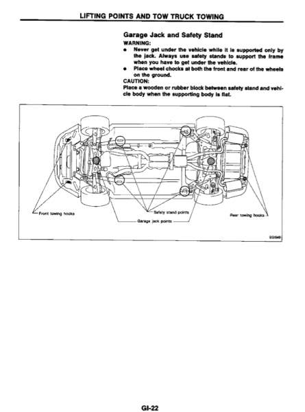

Pics would help me as im not fully clued up with the underside of the vehicle
If jacking the back end up I always use the diff to jack it up, if lowered drive onto some planks of wood first,
If jacking the front I use either the chassis rails with a plank of wood between the jack and chassis rail never bent one yet or you can also use the front subframe where the engine mounts bolt too
Use any of these and you can't go wrong

At the back you can use the front mounts of the rear subframe going in from the side. Or from the rear use the curved lower part of the subframe.
At the front you need to get right in to the main underfloor chassis rails from the side or from the front get under the ENGINE crossmember. NOT trhe rad support crossmember.

Agreed!! The OEM jack, when used at the front, should only be placed under the front door, NOT the wings..... It has the "groove" in it to slip either side of the seam than runs along the sills. There is a section of the chassis just behind this seam, near where the front door meets the frong wing. BUT ensure that the lifting beam of the jack will not foul the seam and bend it out of shape.
