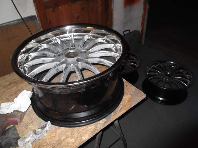

Now my Gold Ultralites are not gold anymore its time to get the second set of 18"s I have refurbed.
They are Fox RS according to the centre caps and are a proper staggered size( 8" + 9").
they fitted the 300Zx they came off without resorting to spacers.
I quite like them but not 100% sure.
anyway I thought I would do them in a similar style to the ultralites. IE .. Polished outer lip/dish and custom metallic anthracite centres...
Ive started... so Ill finish...

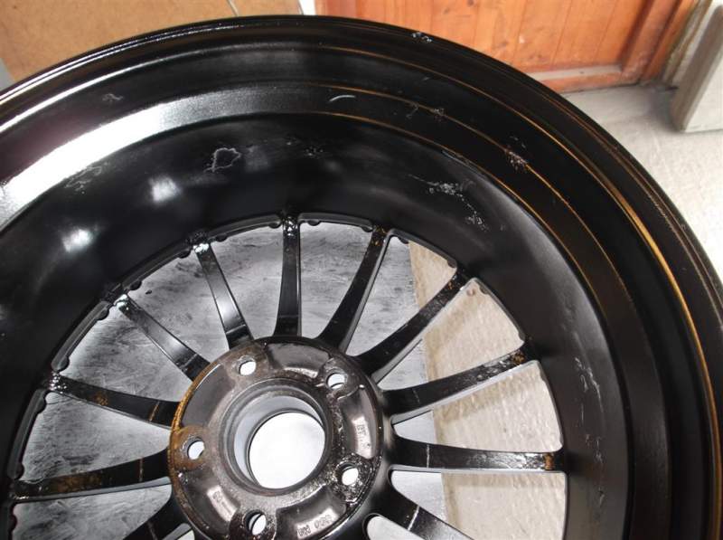

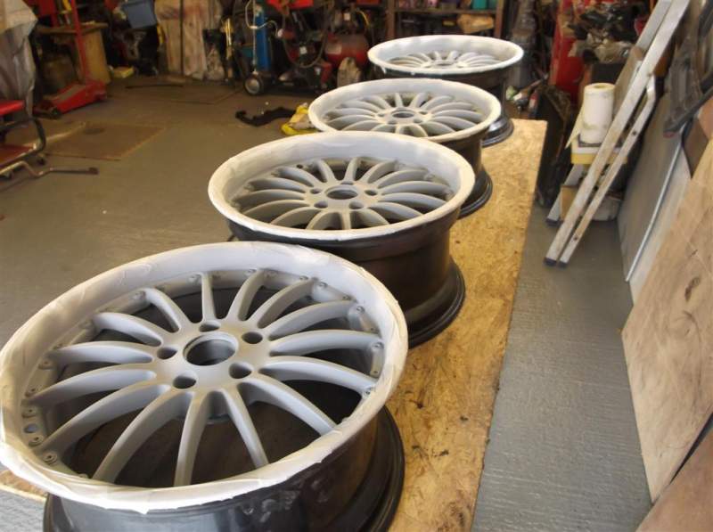

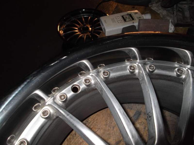

So...................................I will turn it in to a full refurb thread with some pics along the way. I have spent all morning rubbing down . Degreasing. polishing scuffs out and masking up.
Pics to follow.....................................
good on you pete got some very slight curbing on mine and scratches in the laquer to repair, plus i dont fancy paying a company £120 a wheel to refurb!
how much????????:sad:
Im sure I could do them for £119:whistling:
well they say because my 19's are polished lip they have to be diamond cut on a lathe to do them which involves stripping all paint off the wheels, paint, machine then laquer but £440 when i can buy a new set for a few ££££'s more lol
six hours later and we are making progress..................
Masked up...

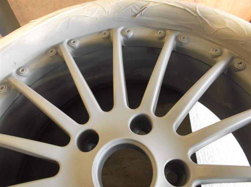

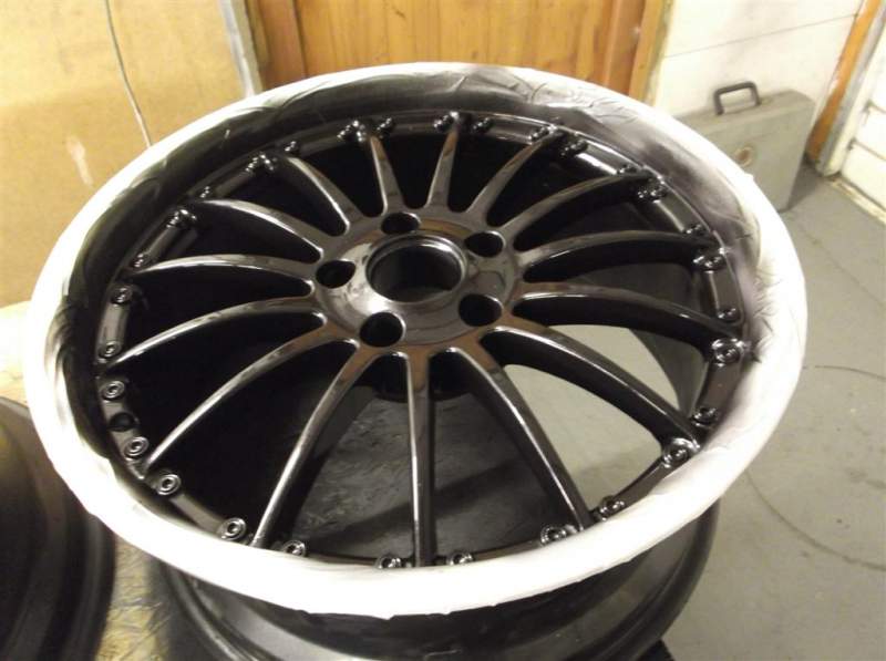

primered..
2K satin black on backs

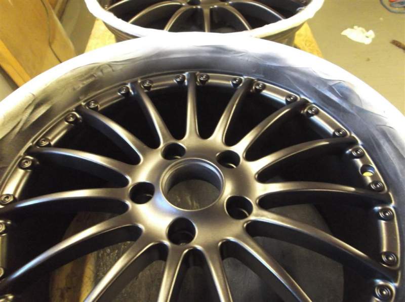

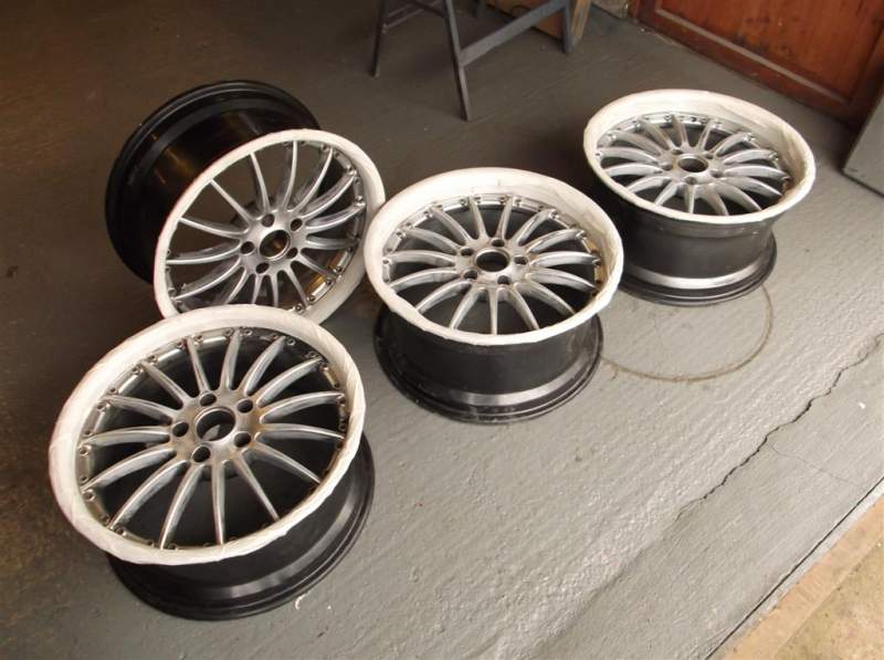

Anthracite basecoat..

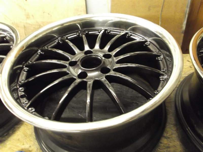

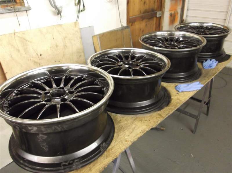

So with several nice coats of 2K lacquer the result looks like this.................................................
Difficult to photo under the strip lights in the garage. i will do some outside tomorro.
It is very shiny tho.:cool3:

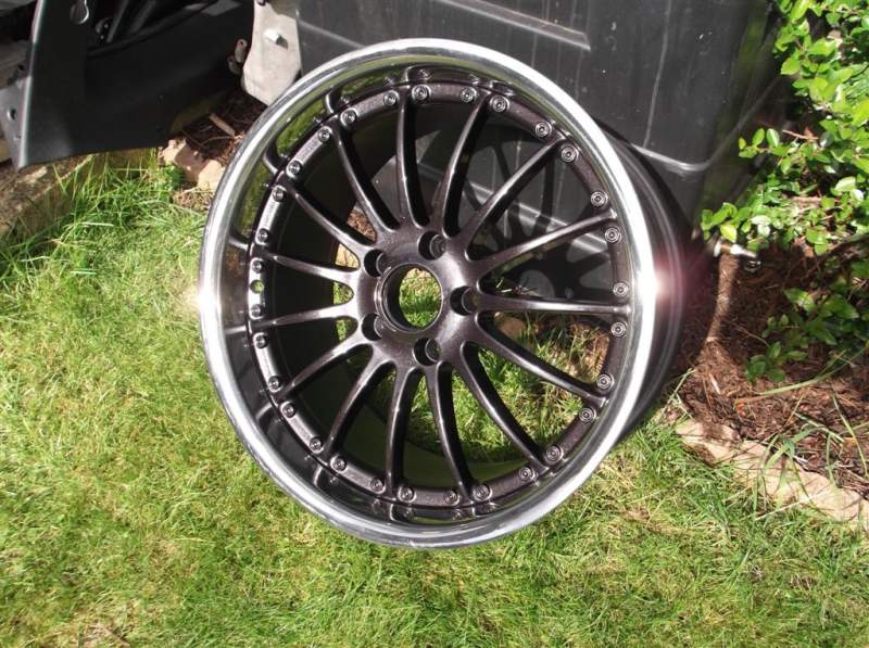

Out in the sun now!
Just got centres to do and tyres to fit.
