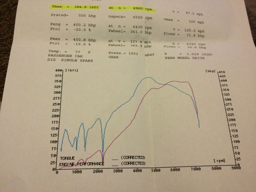

Result of my Remap
Thought id post a quick result of the mapping session with John Dixon
Well, it didnt quite go to plan. Basically, the conzult data port on my zed has some of connection issue that ment that johns software couldnt get a consistant live stream of information, which basically meant it was nigh on impossible to map.
We also found the the Deatschwerk 550cc injectors were doing some very odd things. For some reason on the mapping scales they give the scale values of 440cc injectors. All very odd and ive contacted CZP and Deatschwerk to find out whats going on (the injectors came with a flow chart which showed rates of between 545 and 549cc).
The combination of these things ment that john could only sort out the fueling and timing values for low boost levels (0.8 bar). The car has shown itself to have a fair bit of potential, and the capability of flowing very high volumes of air in comparison to cars with similar spec that johns mapped before
The results were 400.8 flywheel HP and 384.8 lbs/ft of torque (again considering its only boosting at 0.8 bar with no real adjustment of the profecs gain levels, pretty healthy)
Ignore the wiggles at the beginining of the graph, that just john going through the gears
Plan of action is to hard wire a conzult cable into the loom close to the ECU to eliminate any possible breakages in the loom so john can get a consistant connection to map it properly
