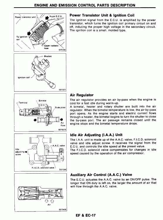

Back of engine passenger side, bolted on to the plenum matey :) It should have a yellow two pin connector attached to it at the top. This is the ICV wire, the one under that is to do with the AC.

I would try another coolent temp sensor, does the AC elec fan kick in at all?
Had the same problem before, and if the sensor is goosed then it overfuels which makes cold starting difficult
Thanks Jaffa' glad you mentioned that as last time I tried my air con it came out warm air!!!, is the temp sensor the one on the left or right looking at the engine?

It's the one with the injector like connector mate :) Right one..

Yeh, one on the left has the injector type connector :-)
Does water piss out when the sensor comes out?
Yeah, mikey's right it's the left one ;)
To your water pissing out Q. you may loose a tiny amount but you'll need to bleed the rad a little too anyway. And DON'T do it when the engines up to temp!!

You could always try connecting a multimeter to it then drop it in a pan of water (upto the sensor part) bring that to the boil and watch the multimeter. Measure resistance and as the water gets hotter the resistance should go down... If the res goes down smoothly then all's good.
