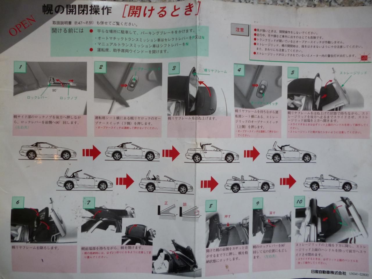

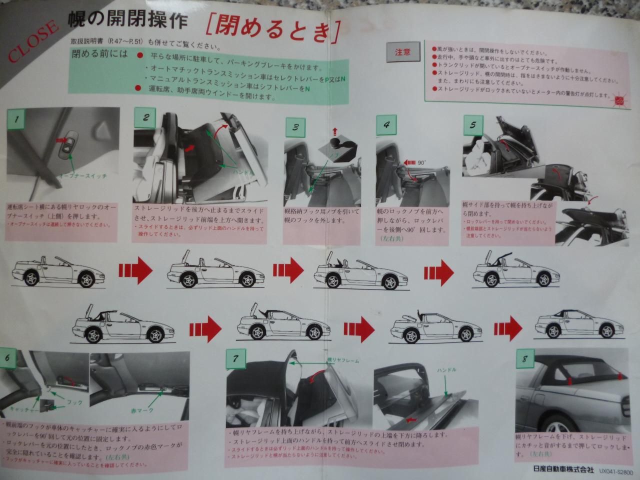

For the convertible owners - oem jdm hood operation instructions
This is the best I could do, photographed the OEM booklet I got with the convertible as it was too big for my scanner.
Maybe worth making a sticky somewhere?
Enjoy.
Nice one buddy, appreciate it :)
Not a bother! Hopefully it's useful to any other convertible owners, even though there aren't many lol
yeah, was good to see that, wonder what all the words mean :)
turns out i was doing it right :)
