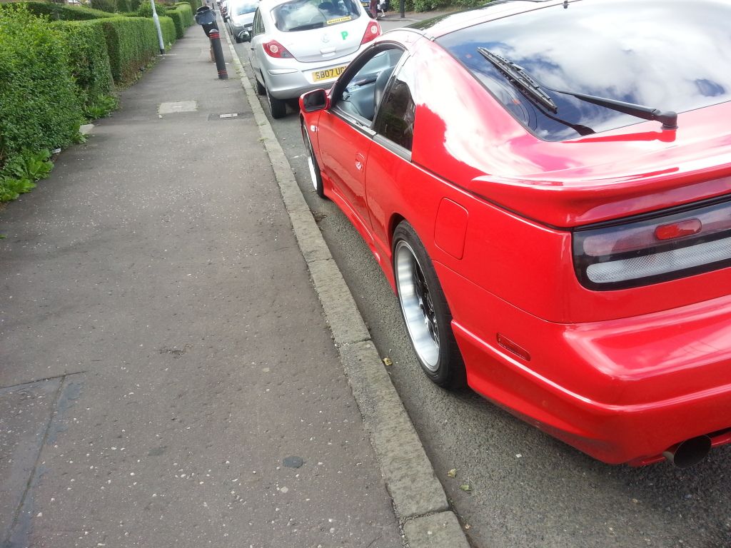

Hi mate, got my new rear wheel situation sorted so no more shredding rubber and stance sorted so I'm back on the road.

Stance before
Stance after
