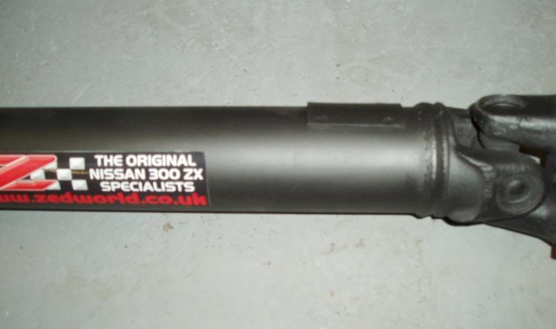

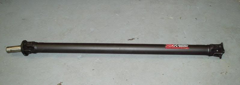

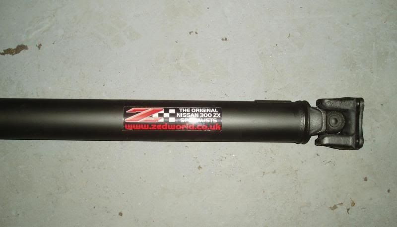

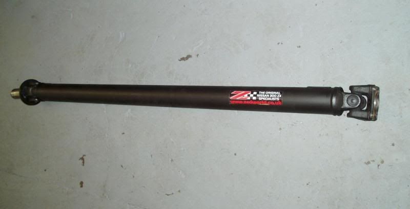

Fitting split parts of two different props will be hit and miss as far as balancing as they are set up as a single unit, the famous centre bearing that many of us have experienced has risen in price at Nissan and now the one piece propshaft is the way to go.
We can supply the newly fabricated single piece prop shaft for both the N/A auto or manual for £225 + vat this is with your prop in part exchange.
As with the TT units the new props are fully balanced and are super smooth in operation, no more centre bearing issues to worry about and at a cost similar if not less expensive than having a new bearing fitted.
All of the work is done by our own fabricator so no waiting for delivery from the US and no import duty, and fully warranted.
