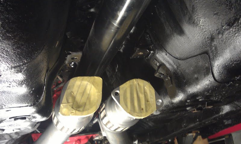

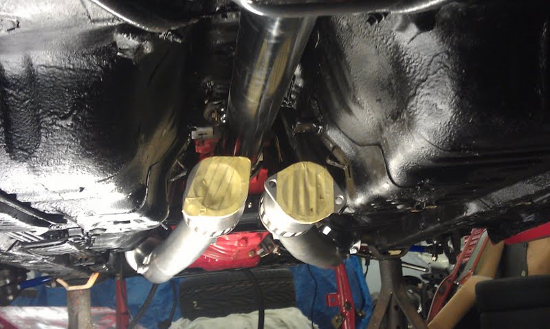

Well good news i think! It was playing on my mind so i drove to the unit to check things out...the last thing i want to do is take the engine out and mess with the turbos oil lines etc.

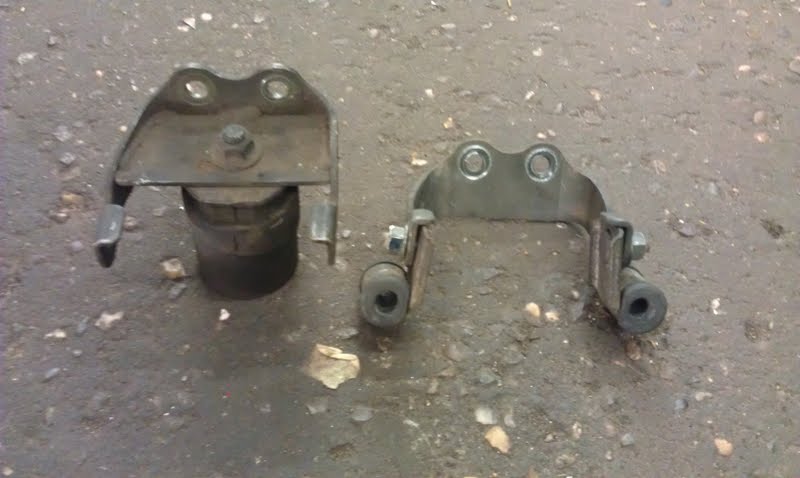

I removed the gearbox exhaust bracket that i know others have had problems with when fitting after market exhausts. I then bolted up the exhaust and they both sit perfect side by side. So now im thinking its the bracket or the hangers on the pipes. For some reason ive got 2 different types of bracket but neither fit well.
I also got better news from Greg who imformed me that if i havent ported the ports in the heads i will be fine if the manifolds are not 100% correctly aligned as the manifolds ports are larger.
So here is a pic of the exhausts do they look like they are in the right position? They are 3" so they will sit slightly different to stock i guess.

Where did you get the exhaust brackets from?.have been after one of them for ages to stop my damn exhaust clattering together when hot.
Mine are exactly the same as that not sure why there out but they fit ok
pipes look in the right place but the flange dosnt should be 1oclock / 11oclock position u need to check your rear pipes are in same position m8
As above really, the right hand flange angle looks far to shallow. Are the hangers on the rear box in the right place? Worth a check.
Thanks for the info ill double check my x pipes when they arrive. I've got a pic of where the hangers fit at home. They are in line with the hangers but the hangers sit higher. I'll post the pic when I get home.
Just thinking the flanges could be that way as they are 3" in diameter. If they were ment to be as stated they may clash or be really close?
