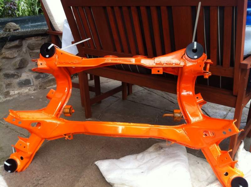

If you have knocked out the metal sleeve around the rim you will need the alloy solid bushes as the poly ones don't fit, I've fitted alloy ones
Nope you do not need the solid alloy bushes.
The Driftworks poly bushes will do the job, I fitted them to mine and the instructions are to completely remove the original bush. But to get the subframe to sit the same distance from the body I had to fit 10mm spacers. I got some cut and drilled from a local engineering shop for £10.
The supplied centre sleeve to my mind is also too short, I could not get the retaining nuts to lock against them. A couple of plain washers did the job of packing them out.

Yep the subframe would sit 10mm closer to the body of the car, so in effect the car would be lowered by that amount. On it's own that would not really be an issue but everything else attached to the subframe would be sitting closer to the body, pipework etc. But for me the main point of concern was that the propshaft would then be slightly out of line. Probably not an issue, but i did not want to take any chances seeing as the props on the Z seem to cause vibration issues at the best of times.

The washers are for the bottom if remember correctly. The other thing that I found with them is that the inner sleeve that they supply with the bushes is too short. When you try to tighten up the bottom nut the bushes were getting compressed too far. The subframe was starting to cut into the bushes, some packing washers cured that though.
