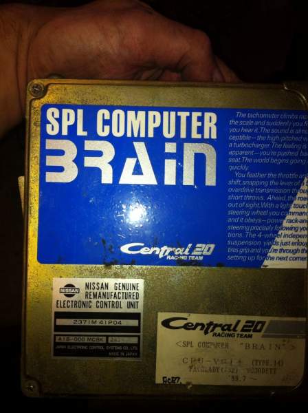

First one is central 20 racing team remanufacured ecu not socketed

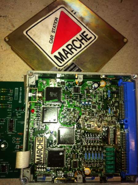

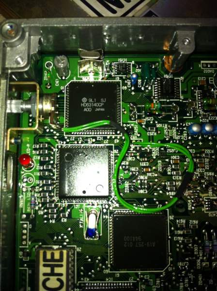

The second is a Marche ecu socketed looks like maybe a switchable map aswell??
Can i change the chip in either of these as im looking to buy a CZP chip
not socketed or switched ....

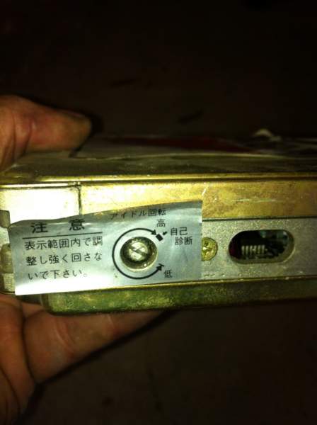

thats the Diag switch ...
both ECUs are just remapped ones for Stock injectors little more boost
The marche one is socketed as ive already pulled the chip out,
Whats the Diag switch, can i just replace the socketed chip?
Hi, just in case you didn't find out by now, the "diag switch" is used the turn the ECU to diagnostic mode, it will blink any error codes the car has (or 55 if all is ok) as far as the ecu is concerned.
there are posts in the TECH section about codes and how to do the check.
