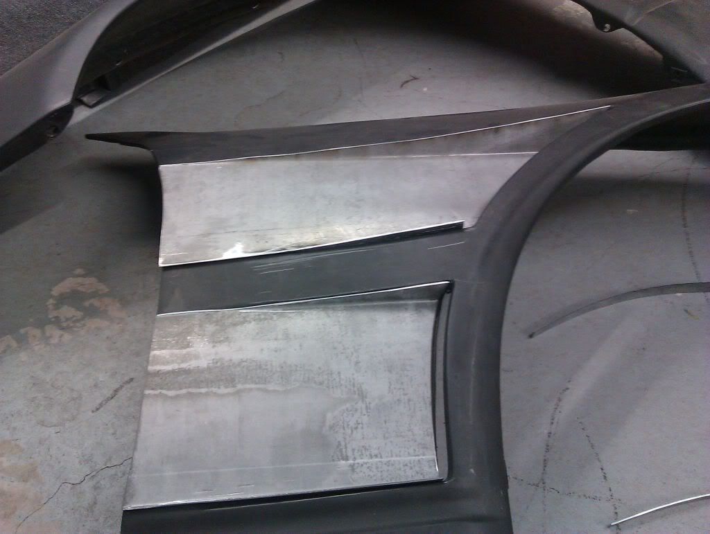

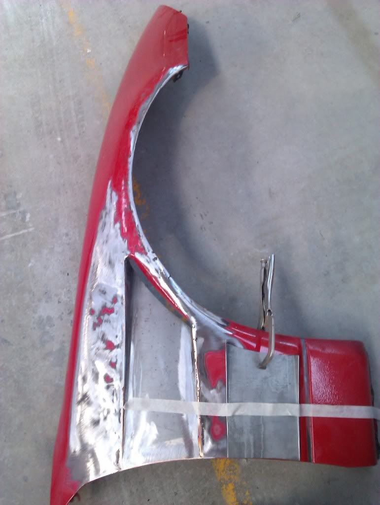

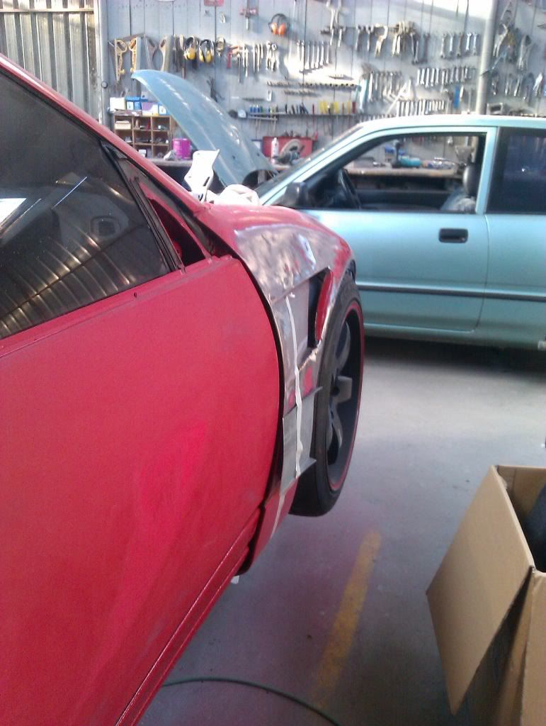

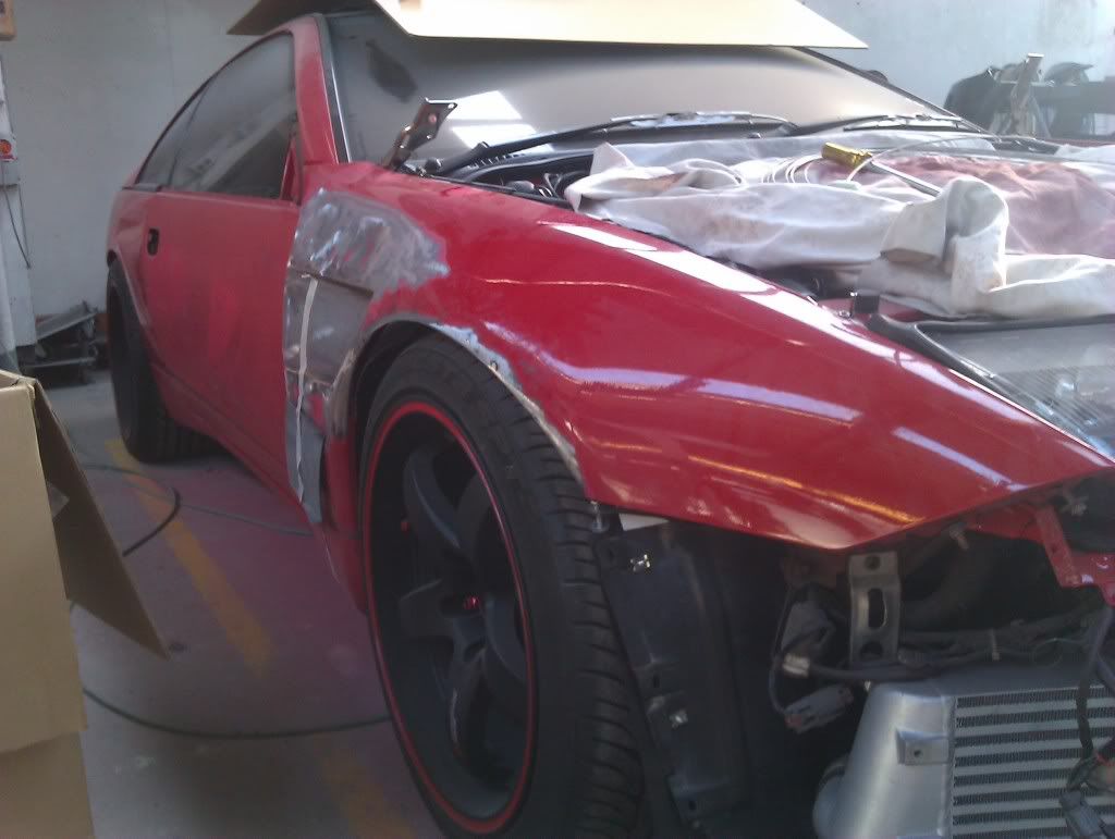

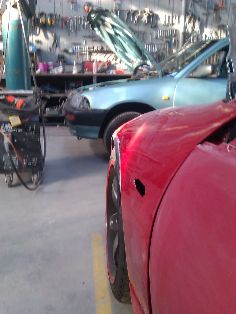

Hi again peeps!! more pics

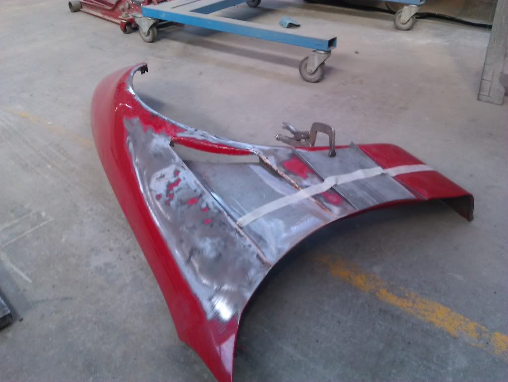

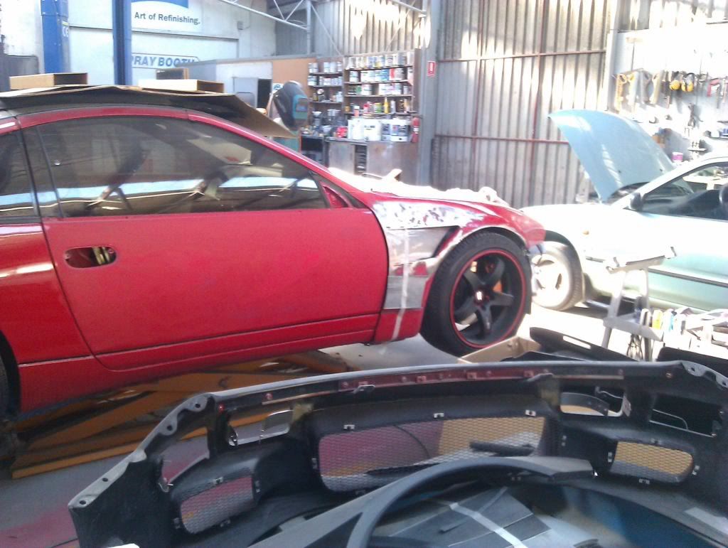

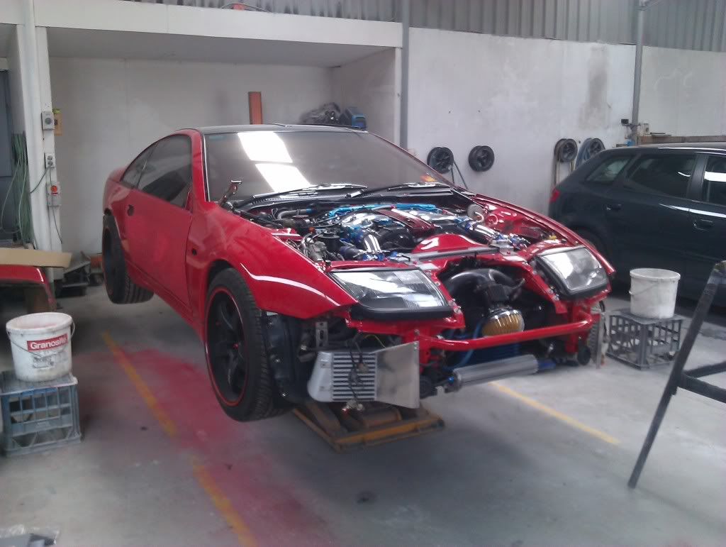

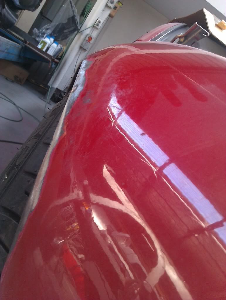

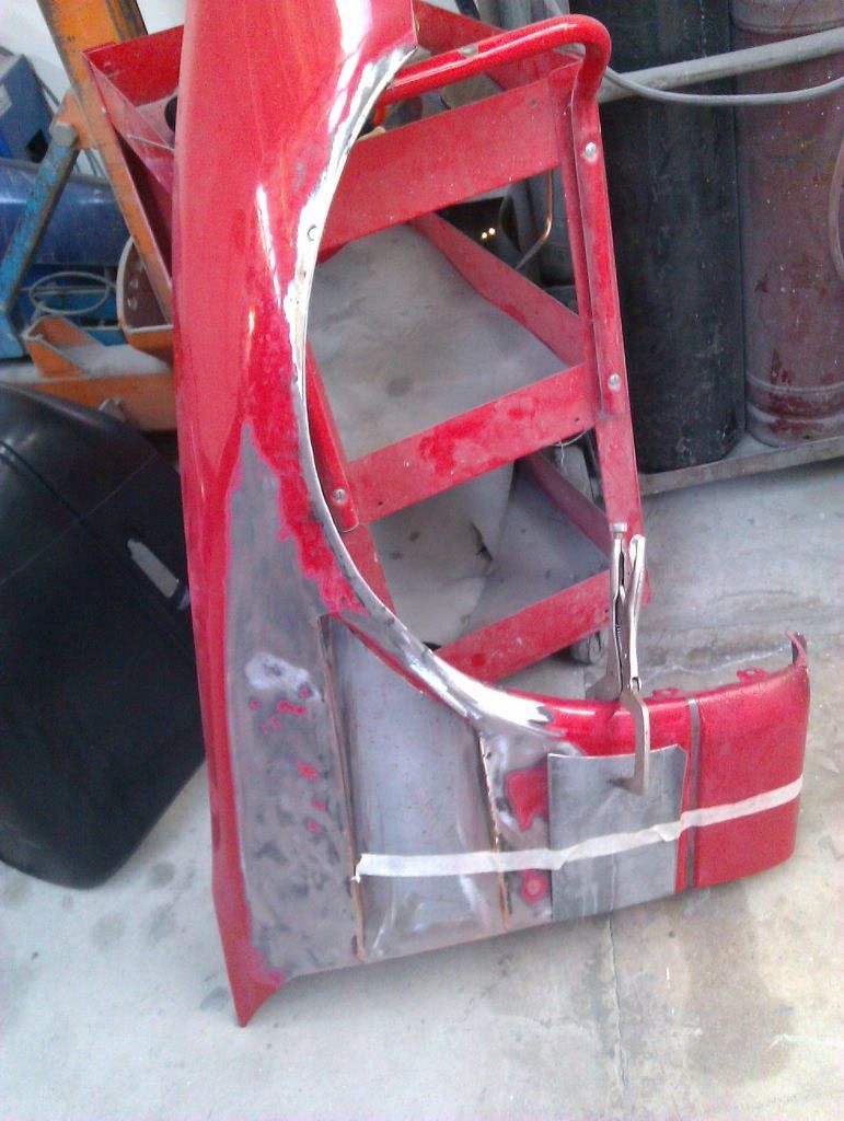

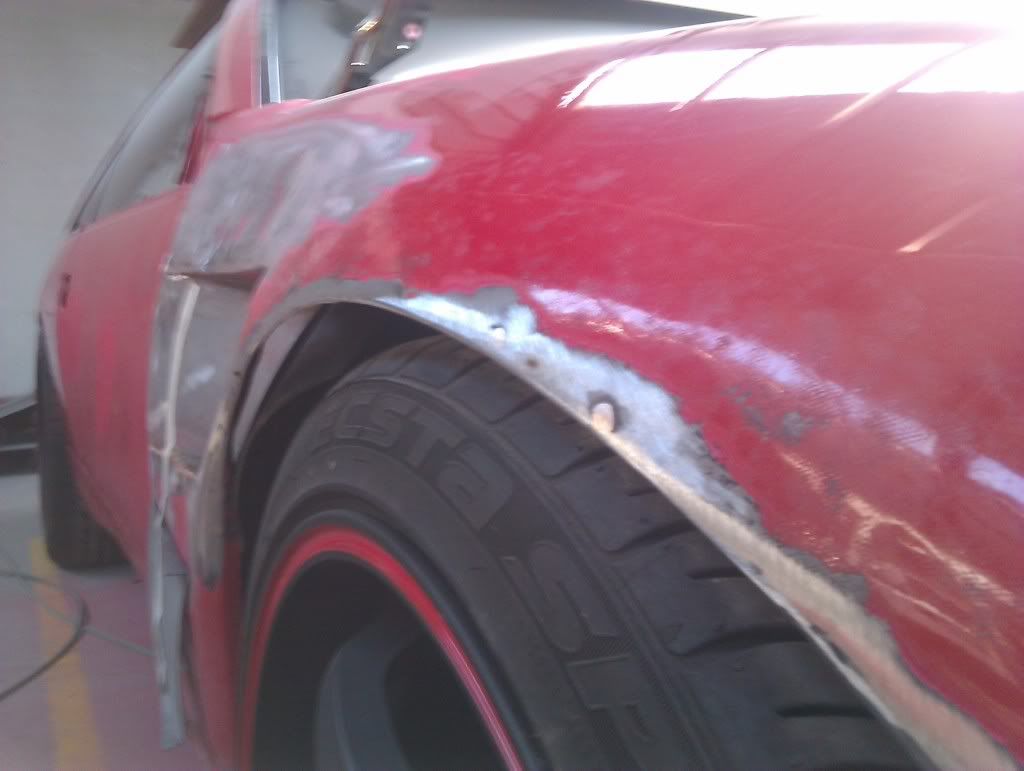

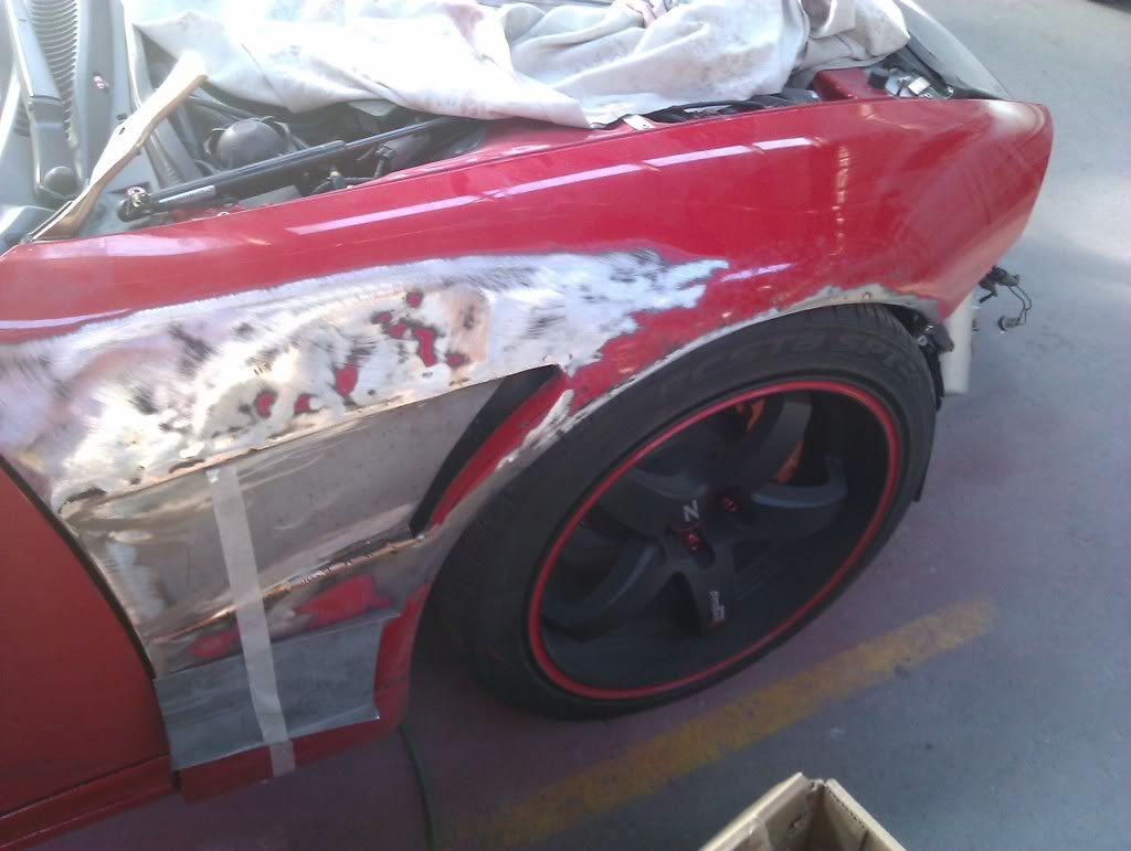

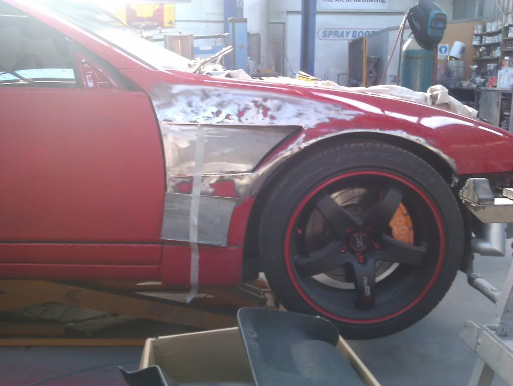

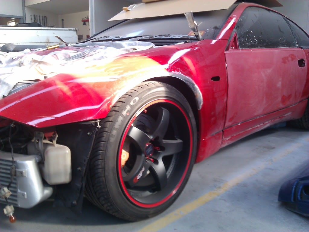

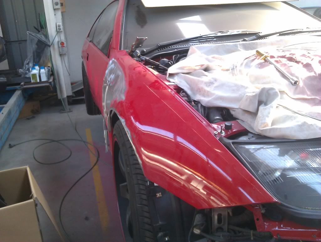

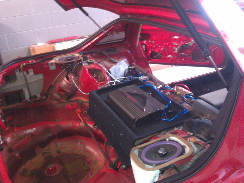

There Has been some big changes as the front guards are Well How can I put this? Oh Yer crap!!! so I have decided to get the vents made and welded in to the origonal guards plus getting them flared and same as the bach guards my mate said that if I moulded those rear over flares on they would eventualy crack (thats the power trix ones) And no there is nothing wrong with them they are very good !!! but haveing them moulded with the filler to blend in with two different densities will evenualy crack and if I am spending all this money thats the last thing i want to happen!! so its all going to be metal and my origonal parts

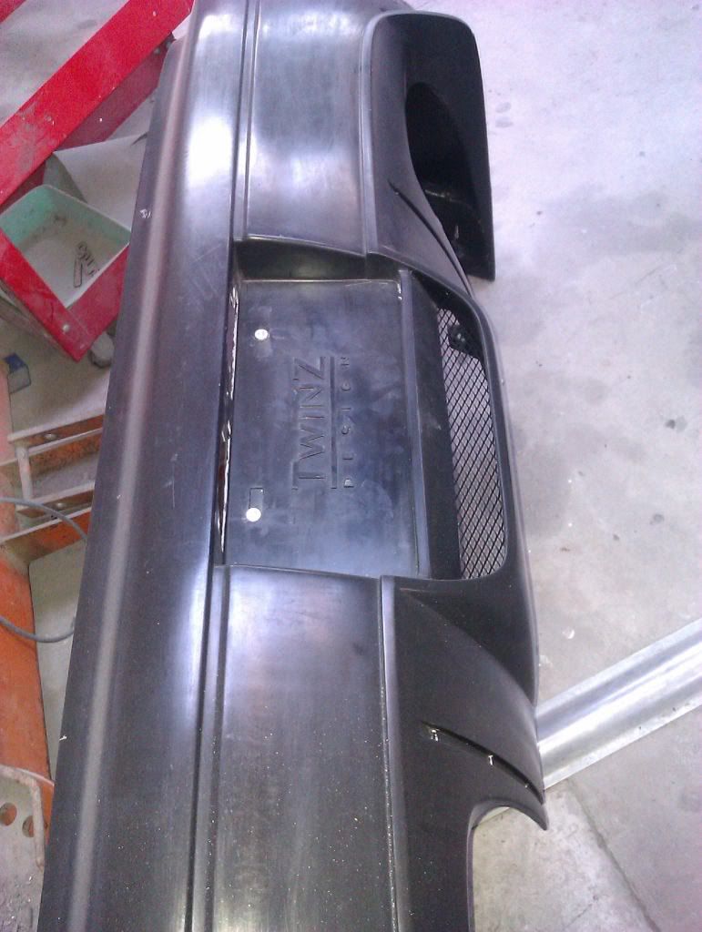

I am realy happy with the job they are doing! Its a bit slow as my mate is down a couple of staff. One in hospital and the other with the flew. But be sides that I love the work that has been done!!! the body worker is old school!! hammer and dolly Ya can see it in his work! looking at it there will be stuff all filler needed!! And I realy like how the flares are going to!! the fiber glass ones i had were wider hense the flareing and the back one will be done to match!! Thats why I have got a twinz rear bar so he can blend with the rear guards!! ps sorry about all the pics what are about to start
part 2 of pics :biggrin: Sorry

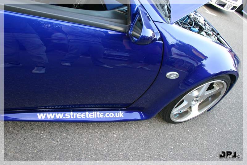

Thanks every one !! :biggrin: There is one thing I have noticed on all of the z forums USA, AUS, and UK that (correct me if im wrong Probably am :laugh:) But I dont ever recall seeing any z Z32 with actual flared guards:huh: I have seen lots with wide body's, over flare,rolled guards, that have gone over the limmit to a sourght of flare but none actualy flared so I dont know how the back ones will look like:yes: If anything like how the front are going I will be rapped !!! so I have a question if any one has got some pics with z with actual flared guards front and back is there any chance of posting them up:taz: Cheers kiff!!
Mate, its great to see some good old 'tin bashing' taking place over fibreglass. Look forward to seeing this project finished. Keep the pictures coming!!
gday Jason! sweet ride!! Yes I have seen this car I thourght it was a fiberglass wide body kit on it:huh:
