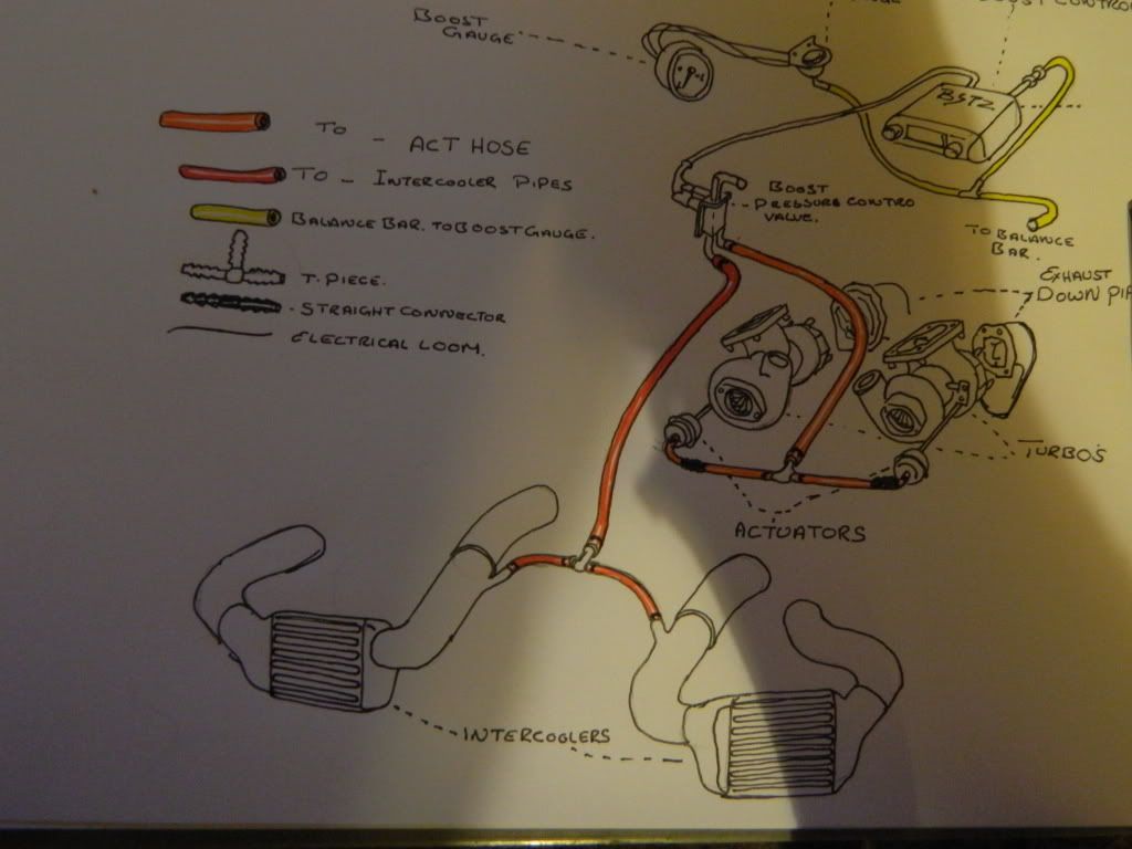

Ok dokey I drew this for my benifit as this is the way I take it that the blitz controller gets plumbed in,does it look about rigHt if not what else do I have to do?
does anything need capped,and what about the old hoses?
I am sorry for being a bit thick,, I just dont want to take anything off that I need,

oh yeah do all the hoses need to be the same size ,even Thee ones coming from the t-piece's,going to the boost valve?
the drawing looks spot on ...
for All the turbo act / boost side need to be 6mm int
for the boost gauge & Control unit 4mm int
thanks in advance

once again Mark cheers,Ihave everything there to fity it now so whoo hoo!
