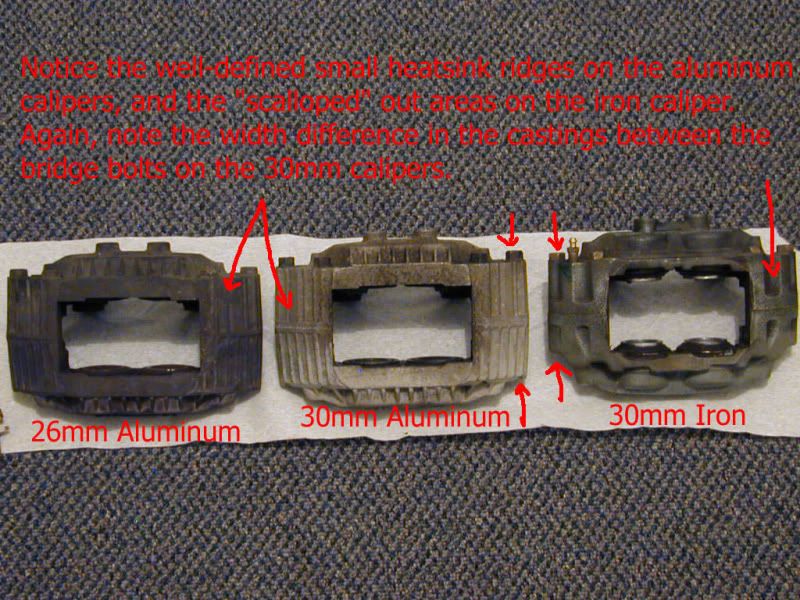

Its only the 89-90 NA that has different brakes than the TT. (26mm wide discs, rather than 30mm)
From 91 onwards the NA and TT used identical brakes.

Its common for 89-90 NA owners to swap to TT brakes so they can source replacement Discs/Pads easier. Thats not the case with a new NA like yours, as after 91 they are all the same.
They look different as I suspect you replaced them with the older Aluminium version (same discs, pads and fitment, just different material and the casting looks different..ie Fins)
Hmm.... Going left to right:
I had number 2 and fitted number 3....
Are you saying other than appearance the aluminium ones are better and therefore I needed only put on the drilled and grooved discs and pads?
We commented on how similar they looked but assumed something internal must have been better on the tt ones......?
