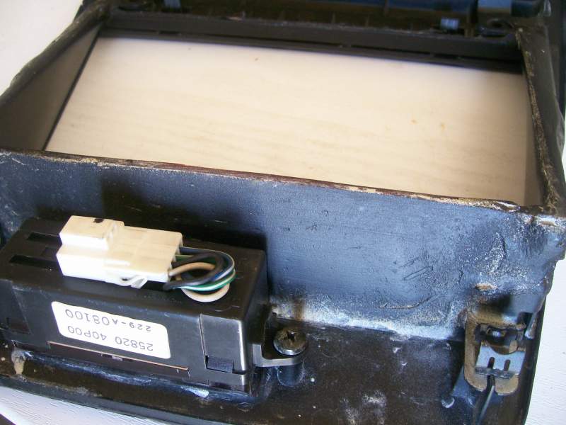

hi is it poss toconvert the radio surround from single to double din fitting have seen a rather nice stereo that i fancy

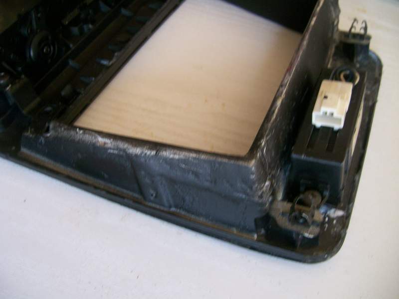

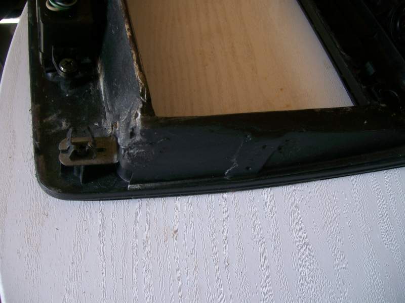

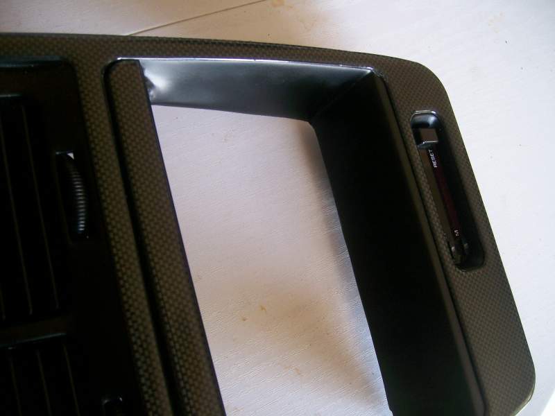

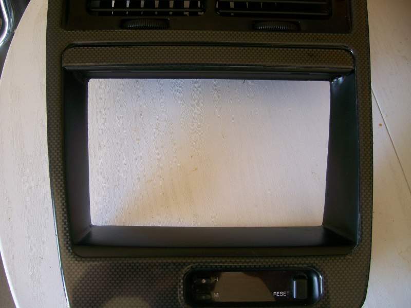

you can get a double din surround via japan but lots of cash, if you can get a spare, and are handy with a dremel, it can be done. if you need a spare there should be a few around. ive got one, but has a 10mm hole for fog light switch if any good to plat with.
I have another unit i could knock up and use as a DIY guide, but these are the only pics i can find when i did mine.
