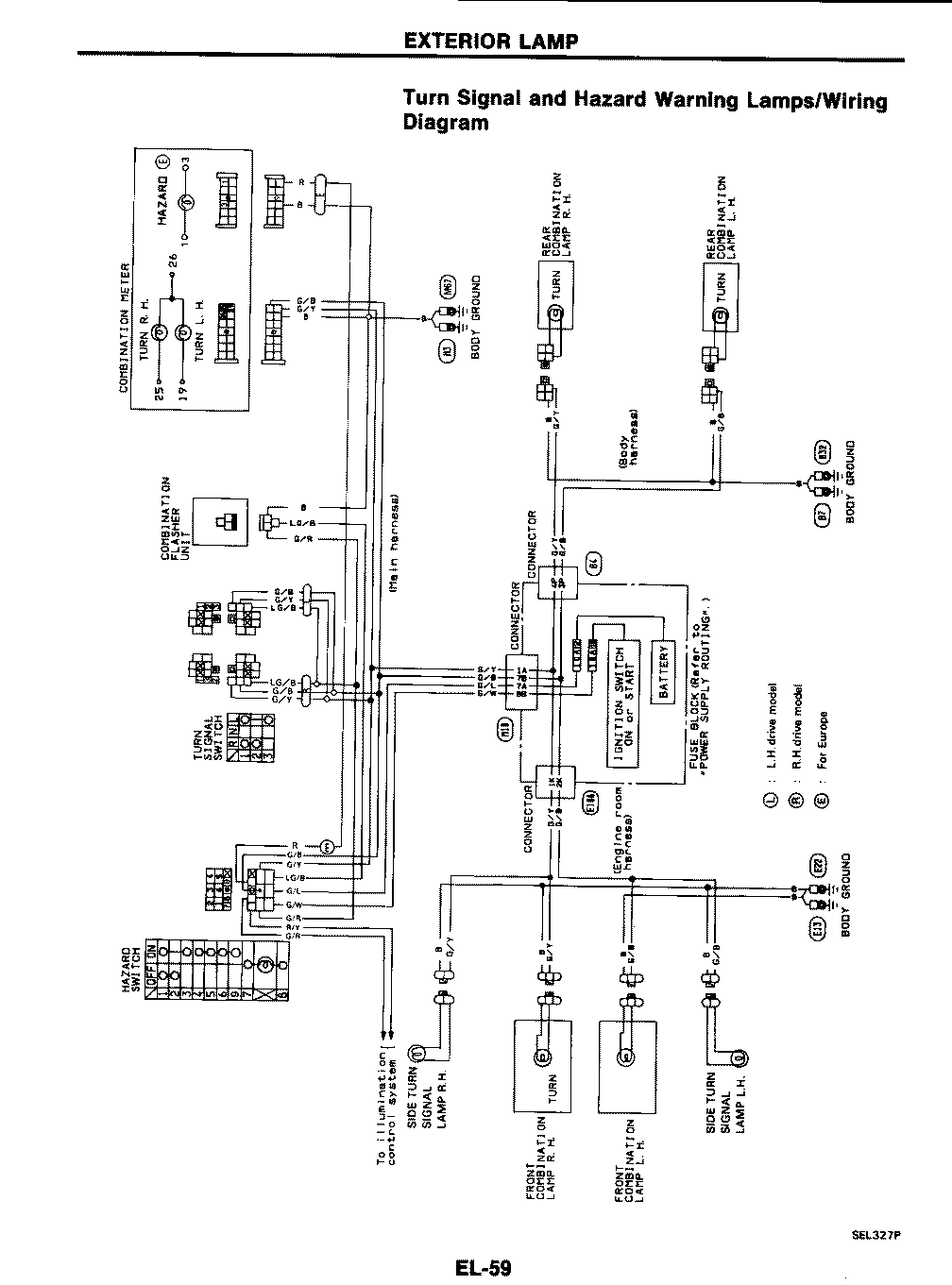

Hi, OK... totally lost now…
indicator issue…. They don’t flash, just stay on.. and if I leave them on the fuse blows.
So, I have LED’s all round, they all work because the alarm system on and off flashes all of them, the hazard switch works and they all flash.
It doesn’t matter what side I turn on it’s the same thing, but only that side turn on.
I’ve replaced the flasher unit and no change, I’ve also replaced the hazard switch and ignition still no change.
I’ve checked for resistance at the indicator switch and both sides good and no leak.
I pulled out the hazard fuse and tried again but same result.
I pulled the flasher fuse and jumped the power off the hazard switch to the indicators and the same thing, they stay on.
I measured the voltage from the supply to the indicators and it shows 12 volts + (engine off) with the ignition on but when I turn the ignition to acc it still shows a slight voltage. When the ignition is set to off no voltage…
I put the volt metre on the fuse box where the supply comes in and I get the same strange slight voltage…(with the acc on)
So I’d say a power leak from another supply before the fuse but after the ignition…
I’ve had the fuse box almost out and almost all the wires visible but still can’t find the fault.
Has anyone else had similar or knows what this could be…. Major hair loss imminent.. :)
