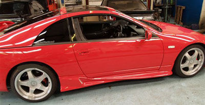

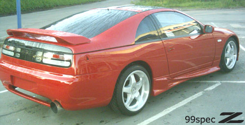

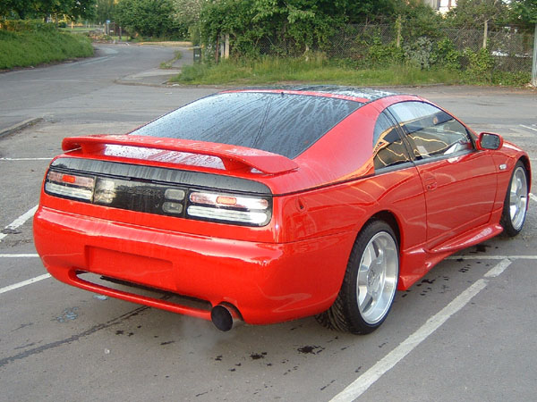

Wow, thanks for the pics!
Like them. But - on my last zed I had in front 8,5x18 with offset 35 (later 5mm spacers per side) and it fitted (of course, offset 30 is probably perfect)
My first thing is only, if it will technically fit or if they will touch somewhere. Got 350Z-Brakes in front btw.

Wether or not there is any fitment issues will depend on spoke design. But the reason I mentioned the spacer is that otherwise they will sit 20mm inside the arches, when people strive for a flush stanced look.
