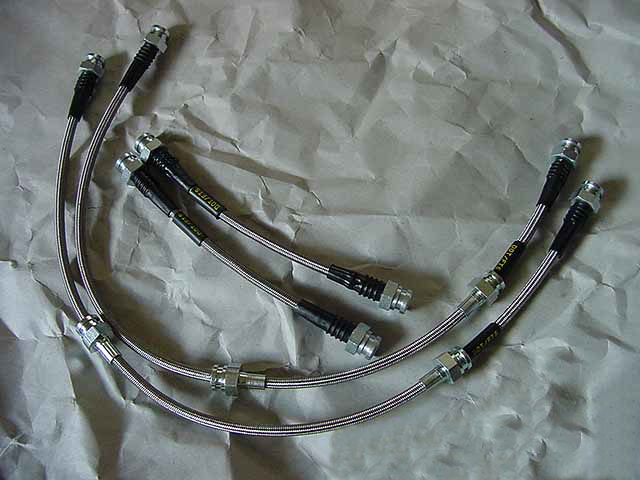

bought a set of these off sumopower on wednsday.now the pack and the lable state z32 300zx but do the fit..do they f00k..female connectors on both ends..now am i missing somthing here

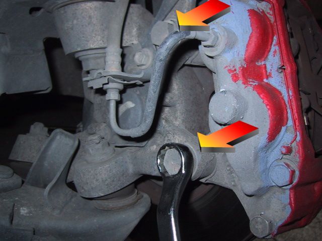

The lines don't run from the hard line to the caliper, they keep a short run of rubber that goes onto the caliper so still a weak point in the system!
Assuming we are talking about stock brakes and lines, then both front and rear calipers have short hard lines between the caliper
and the flexible line. The connections of the flexible lines being female and therefore a replacement flexible line also having female
connections.
Library photos:
Sry mate but it's an old thread. But them pics are completely different from what I got n really they were sold as from the caliper up as all brake lines are the fact I had to spend extra to make them fit determins they were a lie
Sory pal just retread that I'm coming across as a d£;k theyr. My calipers n lines were reworked with different lines but they were sold as a replacement from caliper to lines(coming throught the arch gromit ) but they did make a hella difference when finaly fitted straight to the caliper

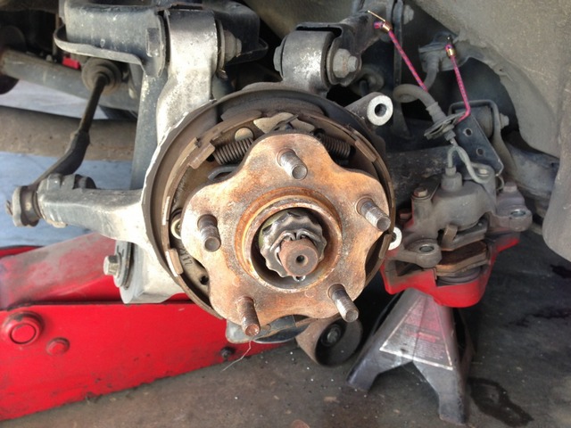

Looks like it was painted by PJ from Southwestzed. :lol:
