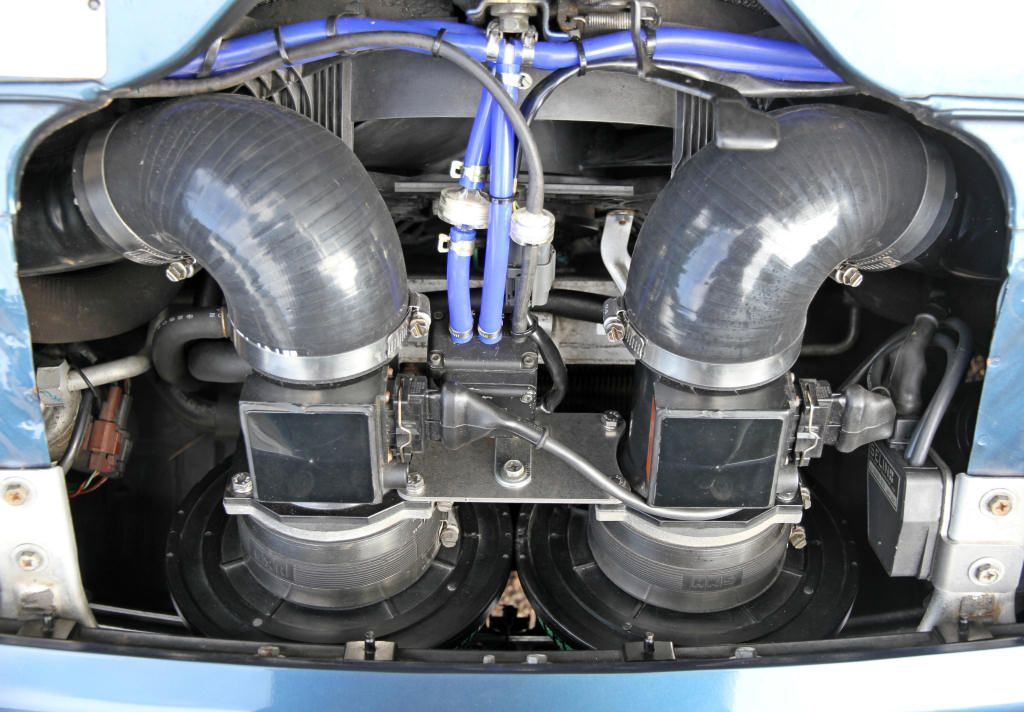

I fitted a Selin Dual MAF Translator and dual intake elbow kit along with a pair of HKS filters in the car.
The setup replaced the single MAF and HKS filter setup I had before. I had to make no changes to the ECU in
order to use the Selin, it is a plug and play upgrade.
You can read about the Selin kit here:
http://www.selindesign.net/electronics.html
The install was pretty straight forward and took about 2 hours to carry out.
I have to say I was pleasantly surprised at the results. The car picks up much quicker than before, with
faster throttle response and better acceleration.
You can read more from Greg Dupree from Specialty-Z here:
http://www.twinturbo.net/net/viewmsg.aspx?forum=general&msg_id=2416119
Getting rid of the restrictive intake T piece which has each bank of cylinders fighting for air seems to be the
key and you can see the sort of gains that are being reported on dynos with the Selin setup.
The picture shows the install of the Selin Translator, dual intake elbow kit along with the HKS filters (the black
box with blue silicon pipes is part of the HKS EVC).
-Andrew

Those of you with this kit already installed - do you have the filters arranged like Andrew's photo (that is, with the 90 degree elbows and the filters pointing towards the front of the car) or have any of you tried to fit the MAF and filter directly to the pipes either side of the picture so that the filters are facing eachother and without the 90 degree elbows? I guess this way they'd either not quite fit, or they wouldn't get optimal air coverage as half the filter is pointing in towards the car...
dont think there will be room for normal sized filters but u may get away with mushroom type ...
mine will be set up as per pic above
