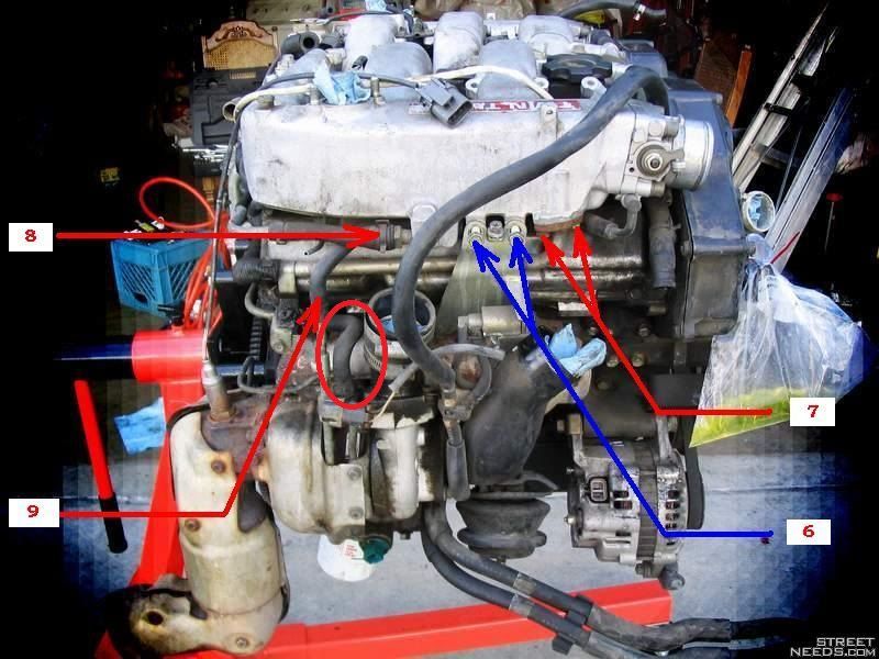

Circled is the pipe that split, omg how much room do i NOT have to work with, ive got the old one off, but getting the new one on is a nightmare as i just dont have the hand space.
there is just about enuff room there but i would take off the upper turbo outlet pipe for light/sight/ & hand room
Ah this went of Dave`s zed when he came to get a part off me so ended up fixing it at the side of the road with a bit of new pipe i took out to him :)
i had to undo the pipe as it goes around the back of the engine, take off the brake slave cylinder and move that out of the way carefully, i then bent the pipe as it goes around the engine very carefully to a new location to make getting access too it easier. its all on now and not leaking.
